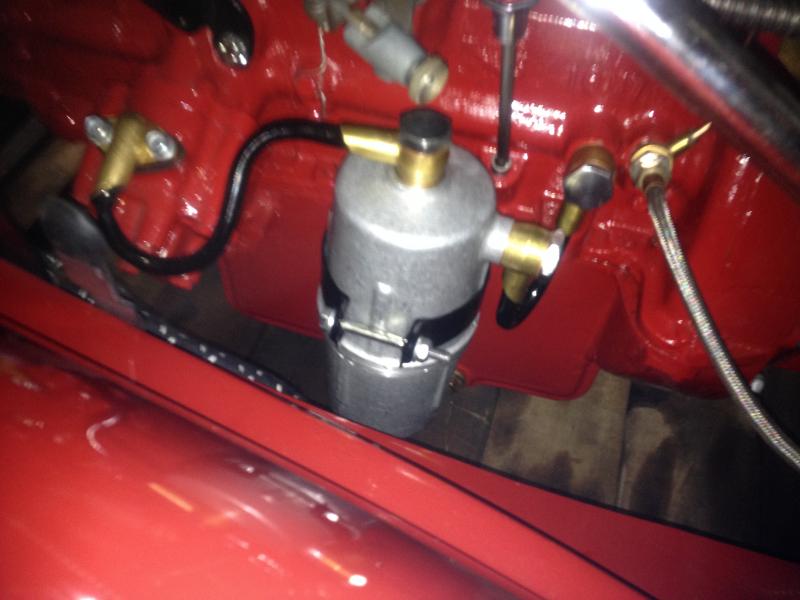

I hoping for some help here as I am a bit stumped myself on the topic of reduced oil pressure. I have a 52 TD with the original style oil filter (the 2 piece verticle cast aluminum remote of the pump style). My car was has had the same oil pressure since forever (I've owned the car for 35 years)....always ran a 35 psi when warm and at idle and on the road 40+.
The car needed a valve adjustment due to lack of power (as a 1st step) and while it was in the shop I had brakes and bushing checked as well as an oil change. I can't remember the last time I did an oil change so it must be some time ago (I rarly drive the car 2400 miles in the past 25 years... Very few recently). The oil filter looked like it had tar on it and the oil was very dirty. Both replaced with new (20w50 and a new filter from Moss at a cost of $60+ just for the old style/size filter).
When I picked up the car I noticed the oil pressure was at 20 and didn't get much higher (maybe 25) while at speed. 25 minutes later when I got it home (all warmed up) oil pressure was at 6 at idle and I couldn't get it up over 20 with increased revs.
I checked the pressure relief ball -all good. So I decided to remove the filter to see where oil pressure was as that seemed to be the only change made that I could figure would result in lower pressure. Without the filter 40psi cold idle... Put the filter back and 20 psi at idle cold. Seems like the filter is the cause but it is supposedly the correct one according to Moss.....any ideas?

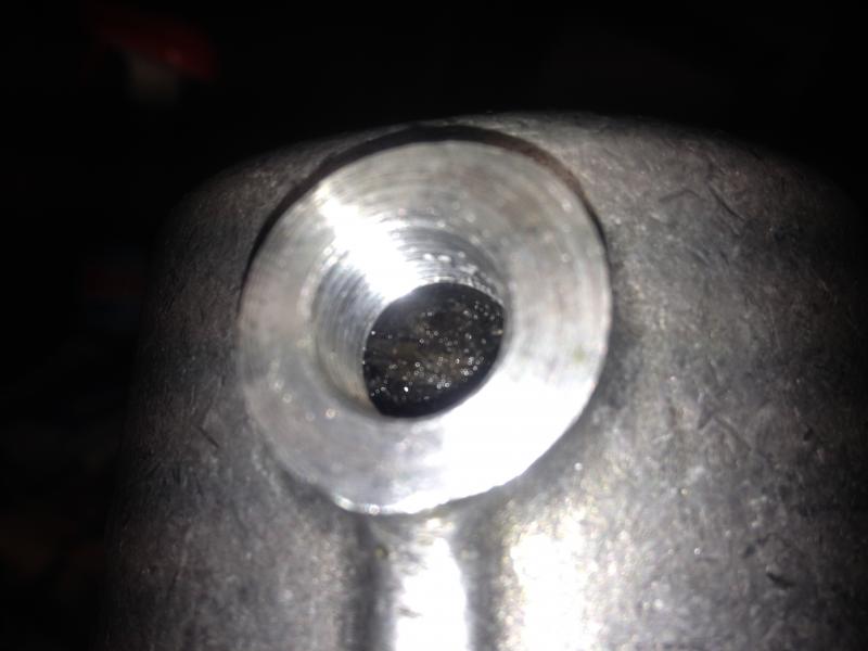

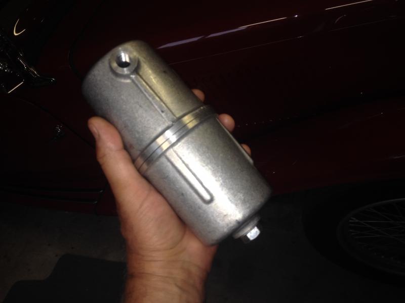

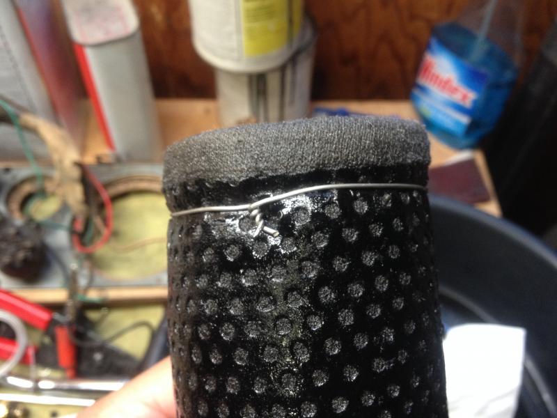

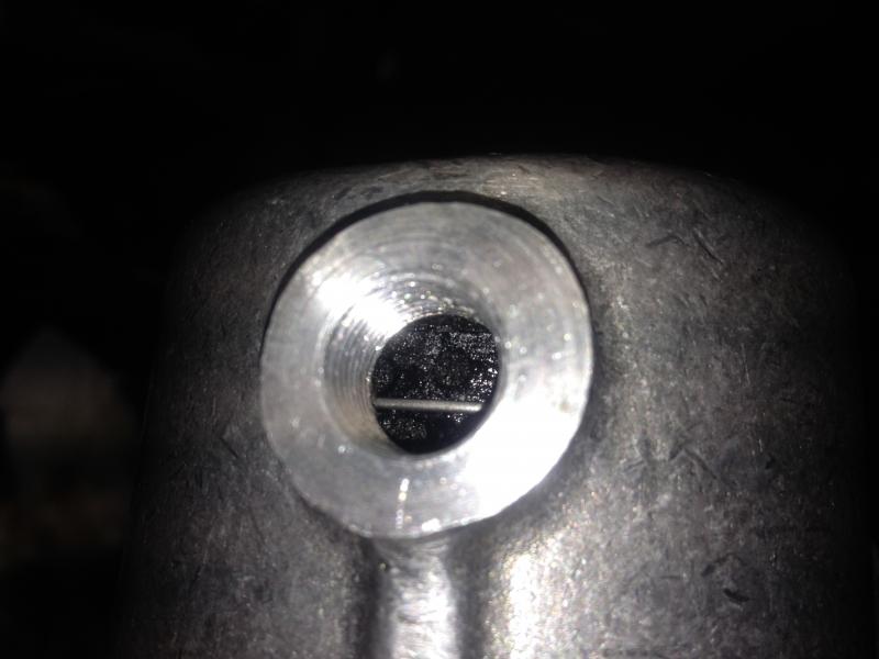

Update !! There is a little clearance at the top of the filter where it fits into the housing and the filter can be moved side to side slightly and positioned and tightened down so that the oil outlet port is covered . The oil under pressure wants to push the filter out thereby covering the port and restricting flow. The sock type cartridge filter is wrapped with a fabric mesh that is glued to the sock so my solution was to band the top with mechanic's wire to draw it in slightly and contain the swelling. Oil pressure immediately went from 20 psi to 45 at an idle. I did try and trim some of the fabric mesh away thinking that would do the trick but it only worked for a bit until the pressure tried to push the sock into the outlet port ( 1st pic). The best solution is a slightly narrower filter , but this is working fine with the wire band. Don't just slap a new filter inside of this housing without checking first.
