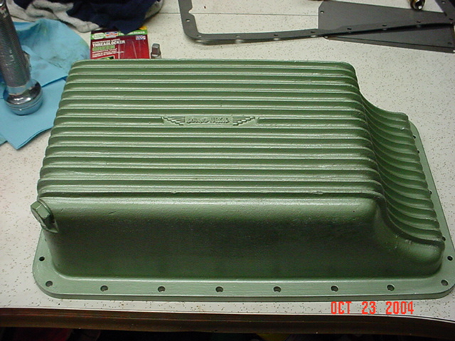

Hi Reid,
The BN2 pan is usually one of the easier ones to get sealed since it has a continuous flange around it.
The usual precautions apply:
Make sure that the pan flanges are flat & free from dimples around the bolt holes. A small socket used as an anvil & tapping any dimples flat with a ball pein hammer helps. Actually I hold the round end of the hammer against the dimple & smack it with another hammer. Better control this way.
Make sure that all pan flanges sit straight & flat against a flat concrete surface or such.
I glue the gasket (two piece with dovetail joints) to the pan flanges with weatherstrip adhesive to keep it from slipping out of place & use Hylomar HPF on the engine side of the gasket.
Get all of the bolts started & pull them up a bit at a time evenly to prevent pan warping & tighten to just snug, about three ft/lbs.
I did later install a DW aluminum pan on a whim. Of course it doesn't have the flange distortion problems & is easy to get a good seal on. It did require shortening the oil pump intake screen which was a bother. It was so heavy that in the limited space under the car I was forced to carefully jack it into place as I started the bolts.

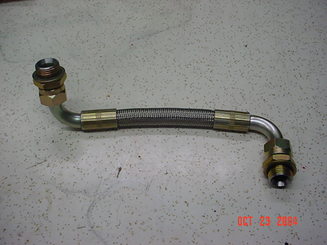

The standard hard line from pump to block has been known to fracture on more than one car. This can cause a real disaster. There are braided steel flex lines available for this & I highly recommend the extra insurance. See pic.

[ QUOTE ]
A side note:
D
[/ QUOTE ]
Mine fractured a few years back--luckily I saw the OP guage needle falling and shut down in time to avoid any damage.
I got a new flex line from AH Spares via Healey Surgeons-I think DW also makes one. In any case make sure that both nuts swivel (I am told that some of the early-manufactured ones did not) as otherwise it would be difficult to install the line in the tight space available.
