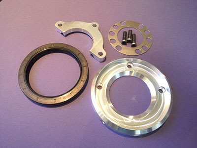

Correct. However, with most machinists these days being unfamiliar with the scroll seal, even many rebuilt engines have not had this little detail handled properly. In addition, and sometimes a result of that, all the correct efforts can still result in a moderate to serious leak. When all else fails, my rear seal kit will cure the problem.
More explained here:
https://gerardsgarage.com/Garage/Tech/SealKit/SealKit.htm
