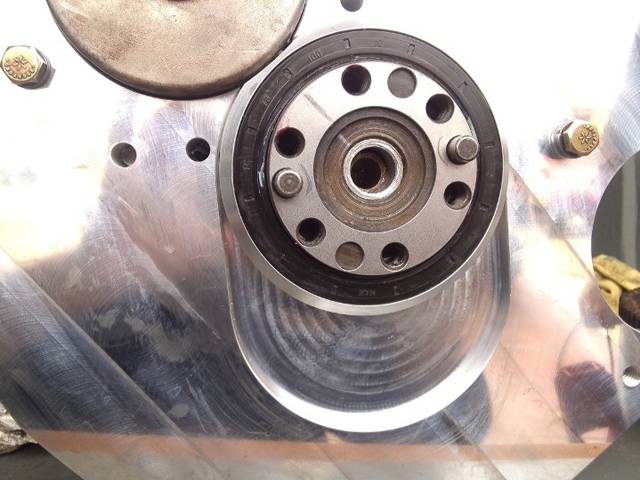

All the previous suggestions are the first line of defense and will in many cases cure the problem when done correctly. The OEM "tophat" style works best. Venting to atmosphere does not make use of the scroll seal as was designed. However, if the half moon seal was improperly fitted or not line bored in place when the crank was fitted, you may never cure it. My lip seal conversion will, and have had several testimonials to that effect. Works with or without the 5 speed conversion.
Contact me off list if you have additional questions about it.
