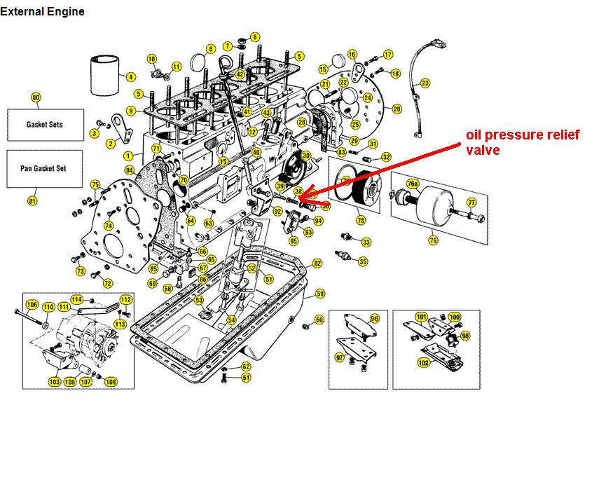

At least in theory, the valve in the filter only opens when the filter media becomes clogged. While there is a similar valve incorporated in the filter head (assuming this is a TR3A), they shouldn't "fight each other". So I wouldn't worry about changing the filter. Almost all of them incorporate the valve anyway, even when they are listed for applications that don't need it.TR3ATR250 said:I was thinking about this for a while now. I have a spin-on oil filter adapter and I believe the filters have a oil release valve in them too. Seems to me they may be working against each other? Should I change filters? I've been using Fram 3600 and Purolator L20195.
I use Fram 3600 filters too on my TR6 and haven't seen any oil pressure gauge oscillation; I don't think that the built in filter bypass is the problem; but if there is a high pressure drop across the filter because it's dirty or because of a manufacturing problem then I could imagine the relief valve cycling which could be the cause.TR3ATR250 said:Mine is a TR250.
