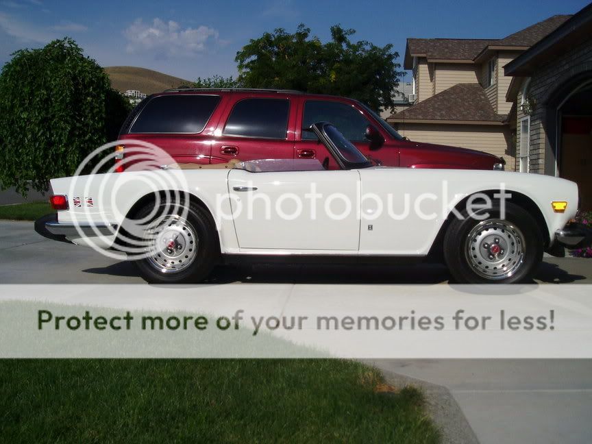

Like the Virginia Slims commercials used say "You've come a long way, baby!" Very sweet looking TR6! I like the white and tan combo. Any more pics posted anywhere?

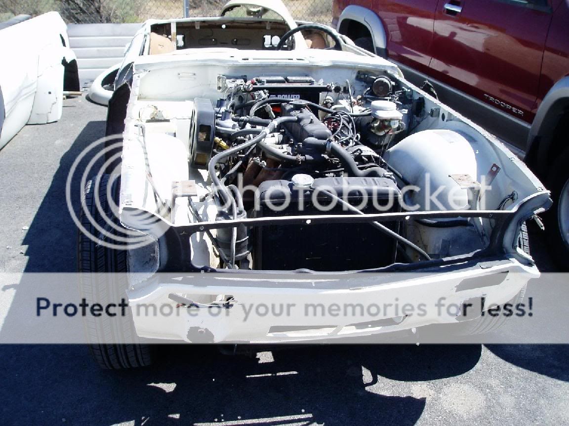

During the re-build.
New everything.
