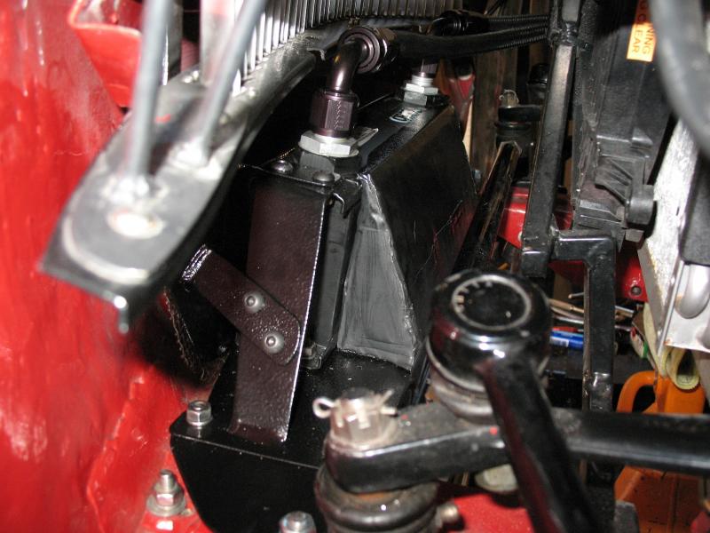

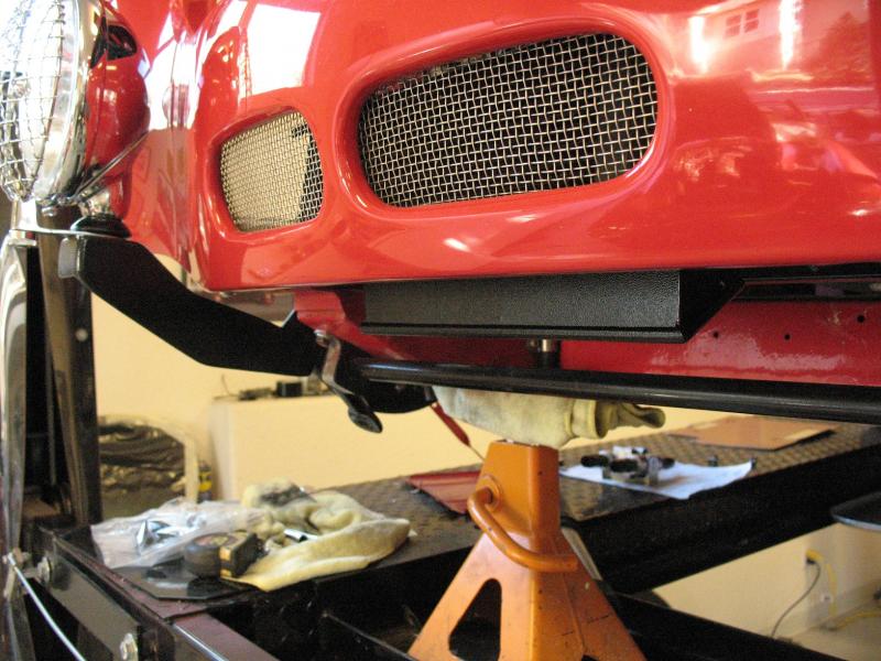

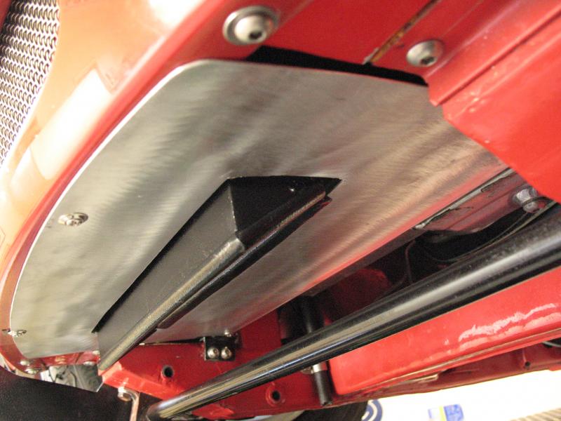

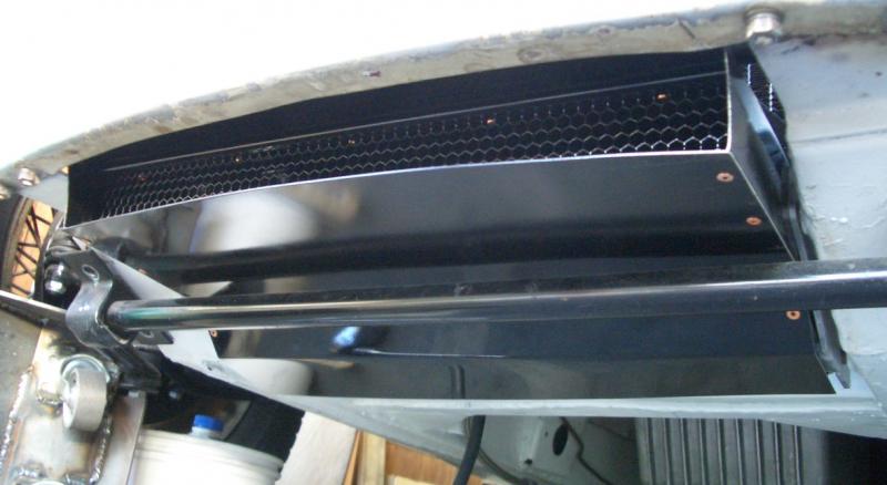

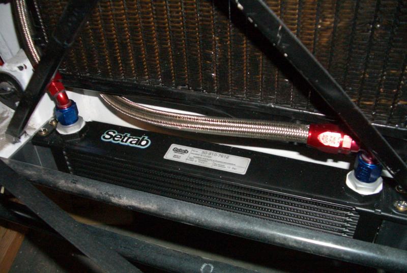

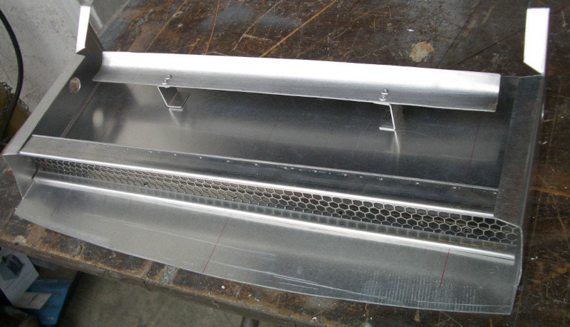

I'm almost embarrassed to chime in after seeing the great fabrication jobs posted above, but I did the old-school mount in front of the radiator. A spin-on filter attachment and thermostat bypass were installed, along with an oil temperature probe in the oil pan drain plug. Coupled with a Texas Cooler fan my Healey did fine in Dallas summers - that said both of us are much happier with the summers here in the Pacific Northwest.
