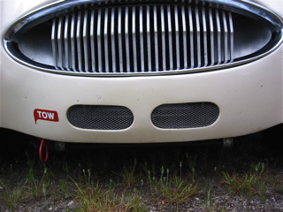

I am going to be cutting some vents in the front shroud at oil cooler location similar (a little smaller) to the ones in the attached photo. I need to fix some mesh behind the openings to prevent rocks, debris and small oppossums from damaging the coiler and radiator. Any thoughts on how to attach the mesh behind the shroud. Anyone on the forum done this? I will not be using the front bumper. All thoughts and ideas appreciated.

I used some #10 stainless steel wire cloth sandwiched between the shroud and a ss "duct" (to direct the incoming air through only the oil cooler). The assembly is secured to the shroud with some thirty (30) aircraft rivets. I chose the rivets (round "cherry" style) to emulate the exposed rivets on the 1954 Pinin Farina bodied 375 Mille Miglia Ferrari.
