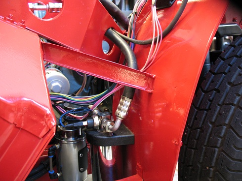

I have an oil catch can on my efi Healey. I have both the valve cover vent tube and the side vent plumbed into it. I did it so I wouldn't be feeding oil vapors (or oil) into my injectors. The can is a modified Reddy can. I can't seem to find a good picture of it... this is the best I could find. The catch can is just behind the a/c dryer and it's mounted on the frame.
I'll see if I can find a better image.

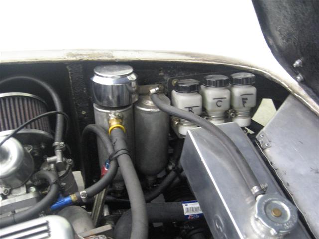

This is the engine bay of my Elva Courier race car. Most race organizations require catch tanks for all fluids. The forward tank is for radiator coolant and the aft one is for oil vapor and the vent on top prevents its becoming pressurinzed. The tanks are made by Moroso and are available at most any racer site such as Pegasus, Jegs, etc.
