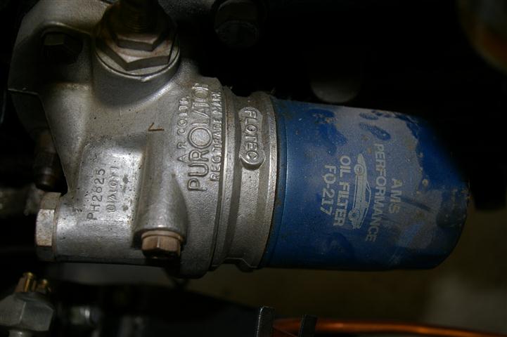

On my 56 TR3, the spin on filter that came with the car had PH2825 stamped on body of filter by previous owner and an AMS FO-217 filter installed. That PH2825 is not easy to track down locally so some other alternative would be nice.
