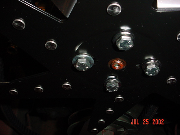

Mine has had plain old lockwashers on it for 50 years. Used the same when I replaced the fan. See pic. Haven't loosened yet. Do you think I should add safety wire?
D
The B engines have a li'l rubber bush like a grommet and a steel sleeve inside that... "shock absorbers". When the rubber gets old/trashed the vibration tends to loosen the bolts BEFORE you get much warning. Then it sounds like a rod knock, and damage can be exponential: Things start to come apart rapidly. I just would rather take the "chance" factor outta th' equation. Hunting for the lock tabs every third time the pump gets R & R'd finally got my goat, so safety wire it is. If it were bolted directly to the hub, I might use just split washers an' a dab of Loctite.

Why? - Is the fan unbalanced? If so, why not balance the fan & bolt it solid? If the fan has harmonics the blade spacing could be changed & still be balanced. Just trying to learn something new. Thanks,
D
Naw Dave, you don't need no safety wire I been doing the same thing for eons, cuz them fold over things ain't no good--- /ubbthreads/images/graemlins/nonod.gif---Keoke
Not sure "why" BMC used rubber bushes, mebbe they thought it would prolong the life of the w/pump... they disappeared at some point later. Keoke is right: don't *need* no steenkin' safety wire, the tabs ARE junk. A later (plastic, multi-blade) fan would negate the whole 'mess.' My reasoning was: If BMC put the tabs there, it would be ~prudent~ to use something less aggrivating, more renewable. Hence the "overkill" of safety wire. <shrug> "Why not?"
DR-E, WE ditched those Mickey Mouse things a long time ago.Initially it was thought the fan's location relative to the radiator might be a concern. Conseguently, we turned an ALuminum spacer with a thicknes the same as the tubes length and bolted the fan up solid,don't even do that anymore.---Keoke
