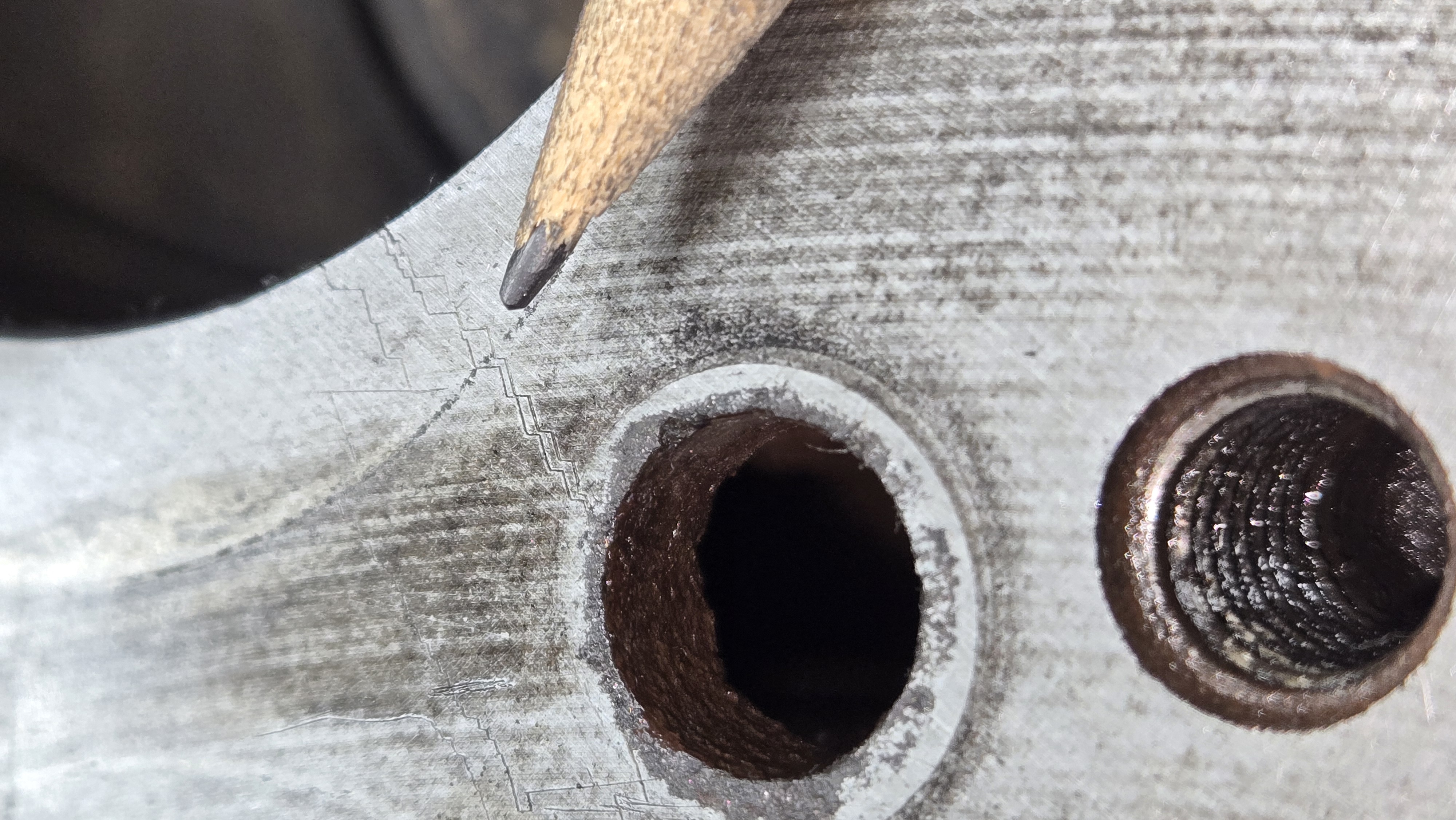

I had symptoms of a blown head gasket on my 1966 BJ8 (but it has never overheated during my ownership). I removed the head and found evidence of combustion leakage between cylinders 2 and 3, and between cylinders 4 and 5. I measured 0.004" warpage of the head between those cylinders. I sent the head to a machine shop for resurfacing.

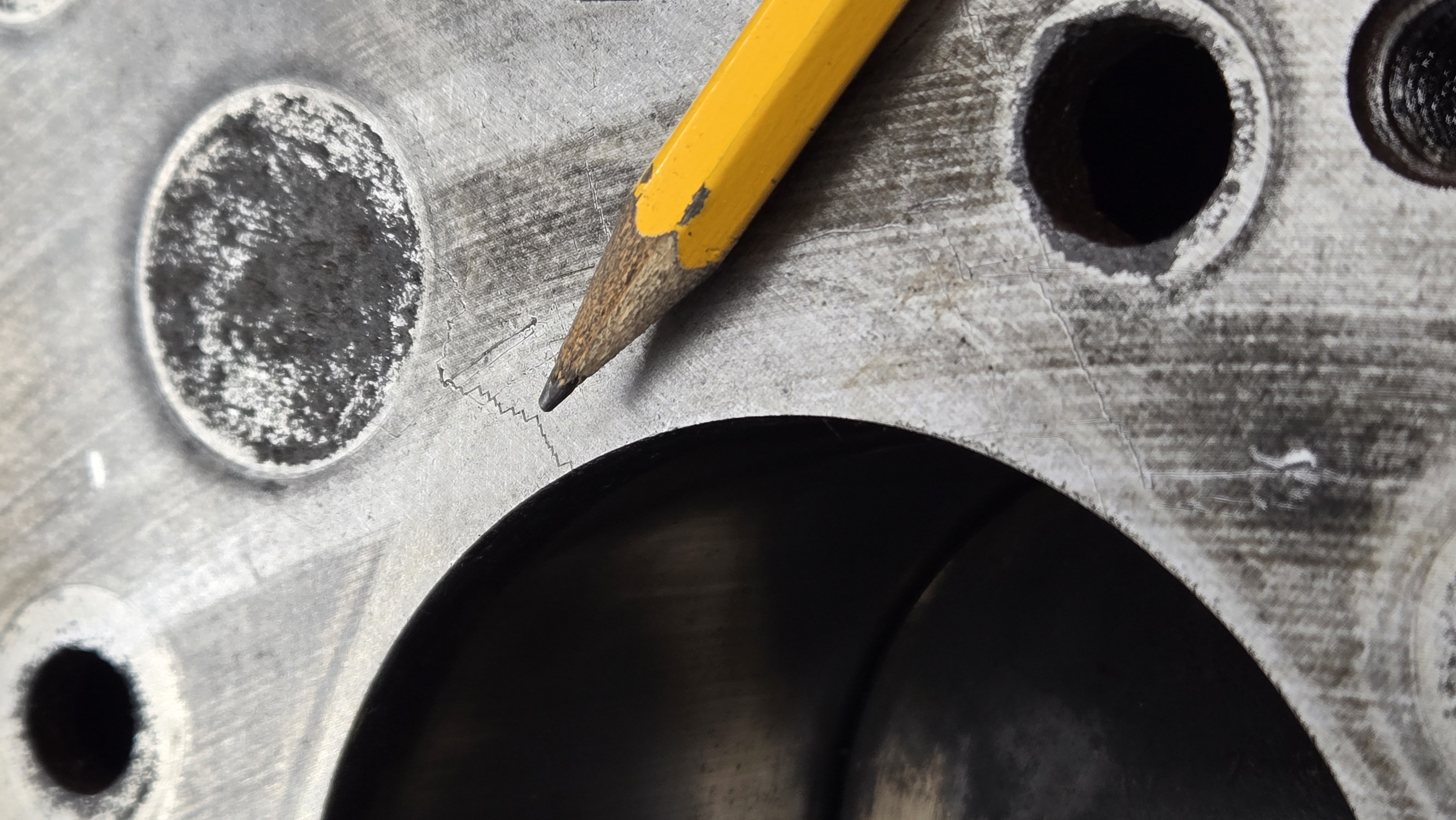

I then cleaned and measured the block deck and found no warpage... not even 0.001" anywhere. However, upon close inspection I found 3 or 4 tiny tiny zig-zag lines. I can't catch a fingernail or razor blade on any of these and estimate them to be no more than 0.001 deep. However, given the unusual zig-zag pattern I'm not sure what I'm looking at: are these cracks to be addressed or casting flaws to be ignored? How can I be sure?
Thanks for all advice.
p.s. I'm NOT pulling the engine and sending it to a machine shop just to have them tell me that it's nothing to be alarmed about.
Regards,
Dean
