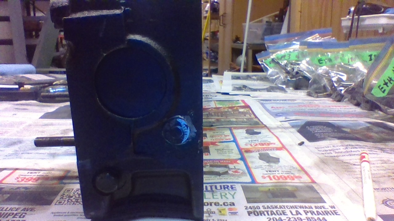

TR2/3/3A Odd cylinder head core plug (picture).
karls59tr
Bronze
The silver colour plug says "void if removed and what looks like CU(H?)ARANILE" Is this typical of a high port cylinder head from this era? Sure does not look like the disc shaped core plug in the Moss catalog? Would this plug be destroyed in a machine shop cleaning? And what is the bolt for at the bottom of the picture?
I saw your post on another forum and replied to it. This is indeed a little tell tale that salvage yards stick onto engine parts. If you overheat that head it will fall off voiding the warranty from the supplier. Its just glued on the surface. Just pry it off if you want.
Many machine shops install these, again to verify overheating for any warranty.I sincerely doubt the
salvage yard idea. During this century, 99.99% of all salvage yards stock nothing older than 10-12 years.
But they do put on these tabs when they sell a motor.
Mad dog
Moss shows a core plug 319-000 for the cylinder head. Why does mine have a bolt instead of that plug (see bottom of picture) Did a PO install that instead? Is this a freeze plug or have some other purpose? Karl

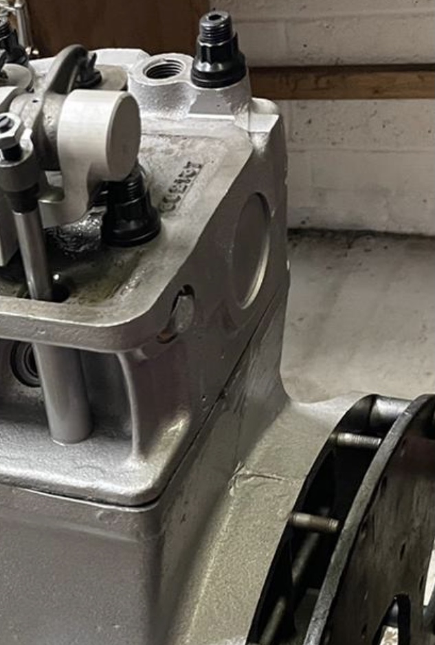

Karl this is the end of the head on my fast engine.
The core plug and oil gallery can be seen.
The sticker has been covered by others and a new build tell tail.

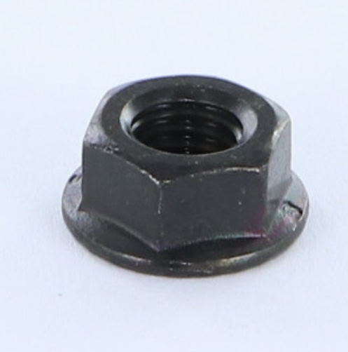

Yes the pedestals are new bastuck Ali type held down with these type of shouldered nuts only.
