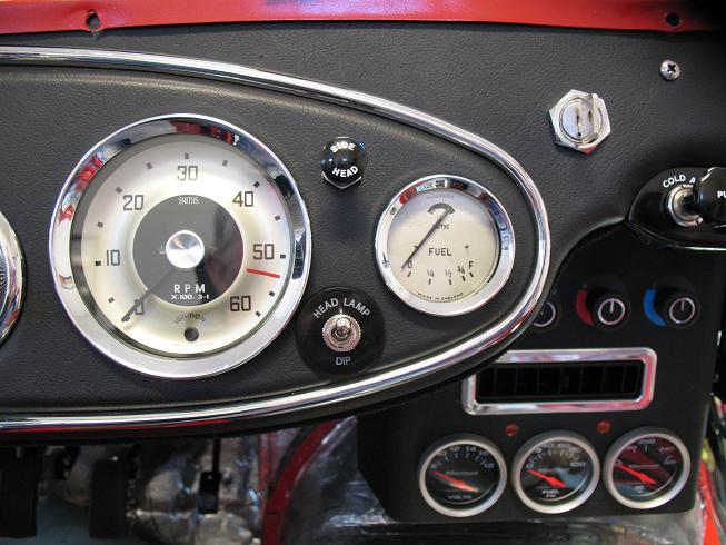

If you want to put the finishing touch on this conversion of your OD switch to a "Head lamp dip switch" as the folks across the pond used to call it I know what you need. I recently found out that XKE's had a dash mounted toggle switch for the "dip" switch....and, of course, there is a escutcheon that states the use of the switch so I just had to get one....pic below
