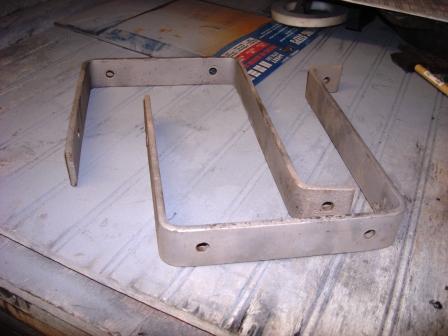

Also, any drawings or availability of the metal brackets out there?

angelfj said:
These are nothing special - just mild steel.
Indeed, mine are homemade from steel sourced at Home Base (back when they were still in business).
