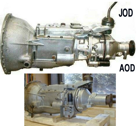

I recently purchased a 72 TR6 with an o/d tranny that the PO had installed half #%*ed. There is a plate that says Laycock de Normanville with a serial number that ends in "A". would this denote the A-type overdrive? Also, missing is the solenoid. It looks to me as if the solenoid would have been mounted horizontal on the drivers side of the unit. Anyone have pictures of what i need to complete the installation? There is no o/d switch on the steering column either. any help would be greatly appreciated.

There is a horizontal hooped bracket that the solenoid mounts into vertically. At the base of this bracket is a nutted stop for the solenoid piston rod. The rod mounts to an arm that mounts to the shaft to the pump.
You need the column mounted switch, upper and lower wiring harnesses (upper is available, but I'm not certain about the lower)and of course the solenoid.
The A-Type is original to the '72. As far as your question about the A designation, I can't say. The A unit is larger than the J model.

I'm not sure about the suffix letter on the serial number, but the first two digits might give a clue. If they are 22xxxx that is usually an A-type, set up to give 22% reductuction ratio. If it's 25xxxx that is usually a J-type set up for a 25% reduction. (Both these assume no one has rebuilt the O/D to a different reduction ratio, which is rare because it's expensive, but is possible and does happen).
If the missing solenoid is, in fact, horizontally mounted as you describe, then it is a J-type overdrive. The A-type's solinoid is vertically mounted. At least this is true on TRs. Both A-type and J-type were used on other cars with varioius external arrangement of solenoids, mounting brackets, etc. Sometimes an O/D or even an O/D & gearbox combo from another car ends up in a TR. (My TR4 has a 2000 gearbox and a TR3 A-type O/D!)
Also, the linkage operated by the solenoid is external on an A-type, internal on a J-type.

wow, thanks doug and alan...I definitely need the workshop manual. The isolator switch is present. Just want to make sure I'm buying the right solenoid as it's a very expensive item. Just can't get a visual on the solenoid set up, but the manual is a good start.
Attached is a pic of the type J OD & the type A OD.
