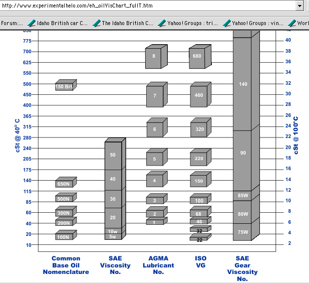

60w might well cure the problem. just remember that Keoke lives in a moderate climate. Some pressure tests by "Quantum Mechanics" have shown that extremely high pressures, high enough to cause serious damage to the OD, can be achieved with COLD heavy oil.
To compare viscosities - 60 wt oil at 40 degrees c = a viscosity of 315 cst. This same oil at 100 c. = 24 cst viscosity.
SAE 30 oil at 40 degrees c = a viscosity of 85 cst. This same oil at at 100 degrees c = a viscosity of 10 cst. Original factory recommendation.
SAE 20W-50 at 40 degrees c = a viscosity of 40 cst. This same oil at 100 degrees c = a viscosity of 18 cst.
To compare, Redline MT-90 is a 75W-90 gear oil. At 40 degrees c it has a viscosity of 20 cst. This same oil at 100C has a viscosity of around 18 cst.
Our transmissions can be well below 40 c when cold & anyones guess about the temperature when warm. A good guess is maybe 80 degrees c.
I believe "Quantum Mechanics" INSISTS on 30 wt oil in their newly rebuilt transmissions. Others, including myself have good results with RL MT90. I believe Triumphs with Type A OD's suggest 90 GL4 gear oil which is at 40 c = 205 cst, at 100 c = 18 cst.
I think the best oil is determined by your transmission's condition & the ambient temperatures that the car is run in. Apparently SAE 60 works for the time being in your car.
There is no single correct answer, A viscosity comparison chart is attached.
D

Daves viscosity chart attachment is a keeper - thanks.
