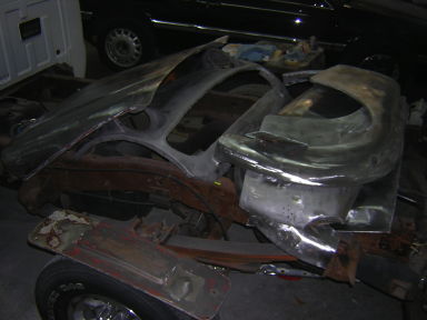

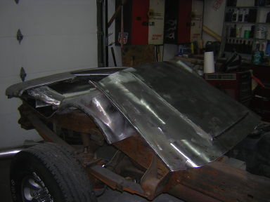

I went up to the shop where my body parts are being stripped and painted. Jamie wanted me to see what he'd done. Next week, he primes 'em!
Looks like a scrap metal yard /bcforum/images/%%GRAEMLIN_URL%%/devilgrin.gif
Those photos sortof excite me.... Have I been married too long?
Golly, more TR-3 porn, heh!
Tinkerman
The sensuous curves of her boot...... Oh yeah, this isn't Penthouse letters...
There's something about looking at a body in pieces right after Halloween.....
Do these panels need any body work? I'm good at naked body work. /bcforum/images/%%GRAEMLIN_URL%%/jester.gif
"Next week he primes them" are you freakin daft??? it will be well and truely too late by then!!! White steel must be etched and primed within hours of stripping,otherwise it will start to oxidize and the primer will fail.....
Dont learn this one the hard way, get it done right or it will be wrong!!
MD(mad dog)
MD(mad dog)
Jamie is not finished with the prep. His work is way better than I can really afford and he knows how the job ought to be done. I was just treated to a display after the first rough out.
