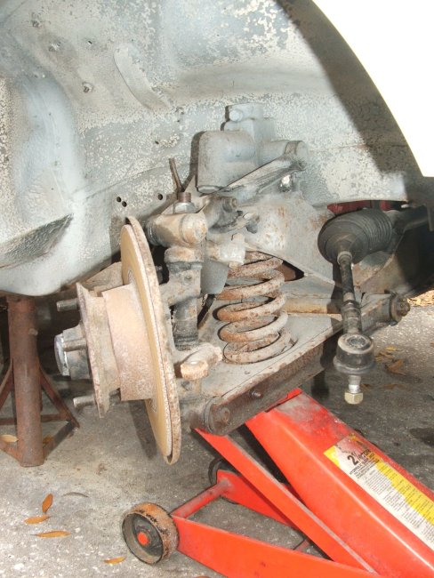

Meanwhile:

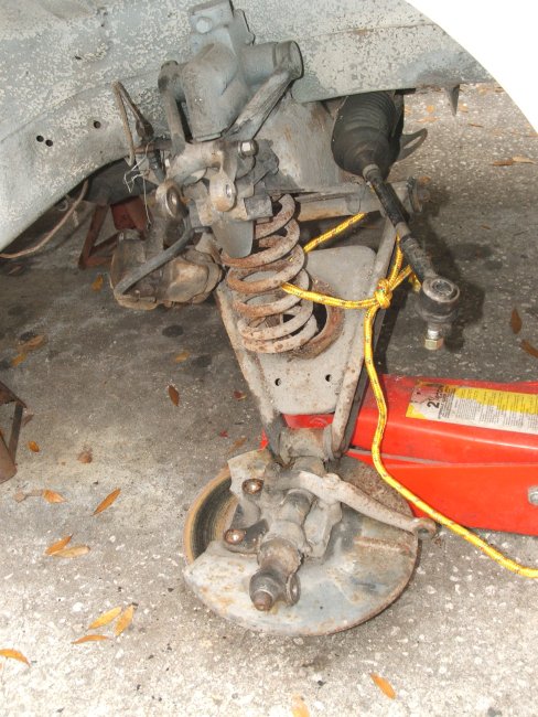

Spring removal... th' rope in frame 2 is there as a joke for Tony from me. Totally unnecessary, but for th "frady-cats" it'd give a bit o' false security.
frame 2:

As near as I can tell, that rope is an elastic type. Now we all know that in order to stop those springs from bouncing off the roof rafters and back down onto the floor, thereafter to konk you in the noggin you should always use NON-elastic rope. That elastic stuff won't even knock 50 lbs of foot pressure of that projectile.
Doc, hehehehehehe........
But, for the guys who do not know better, the front springs of an MGB <span style="font-weight: bold">CANNOT</span> leap, spring, bounce, jump, etc. out of the spring perch! Just jack the car up in the air, remove the caliper, & disconnect the top of the stub axle assembly from the shock & let it fall over - the spring <span style="font-weight: bold">CAN'T</span> - I'll say it 1 more time - <span style="font-weight: bold">CAN'T</span> go anywhere! It might roll out onto the floor if you work to really push the lower spring perch downward but you gotta work at that!
Doc, you silly G.I., you make funny......

Doc, on the other hand: Yellow rope? Doc, you are taking apart the suspension, you want to clash! Green or red rope, please! Have you no fashion sense, dear boy? Geeze!
Colin
It was what I had close to hand... it ain't elastic either. But if I'd thought it out I'd a used a bungy cord for the photo.
