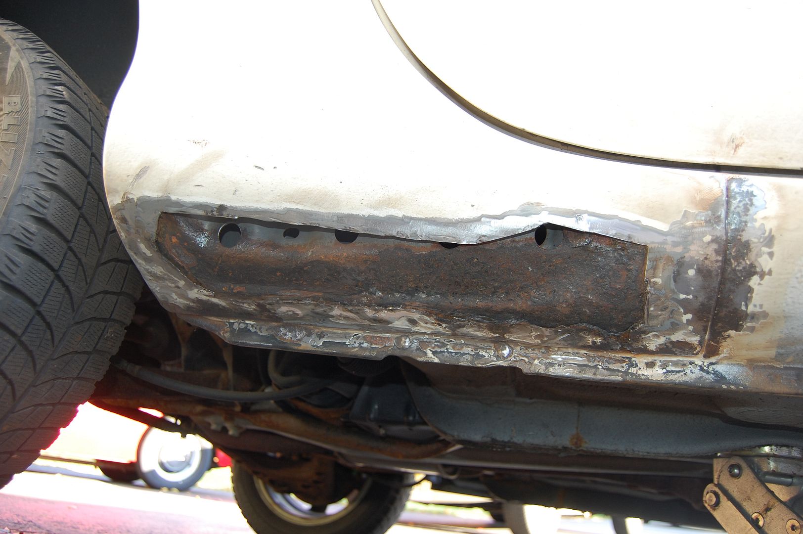

I've been working away on my daily driver Miata to at least make some passable rust repair before Winter.
I bought this car new in 2000. It's been driven every Winter plus always parked outside.
Over the last 14 years, I've probably washed it maybe a total of 14 times (or maybe less!). It still has the original battery.
Anyway, the back area of the rockers on both sides have succumbed to road salt and other issues. So I cut away the rot until I was at "good" metal and used my MIG welder to patch in a plate on both sides. Cleaned up and painted as much of the "behind" area as I could.
It's now Bondo'd, sanded, painted and finished (just before we got hit with snow!). Looks much better. I may even wash it!
If it holds up for another few years I'll be happy. I've been looking at the new Miata and am very tempted......
Here's post repair ugliness (I don't have any shots of the finished job......it's too cold out)
