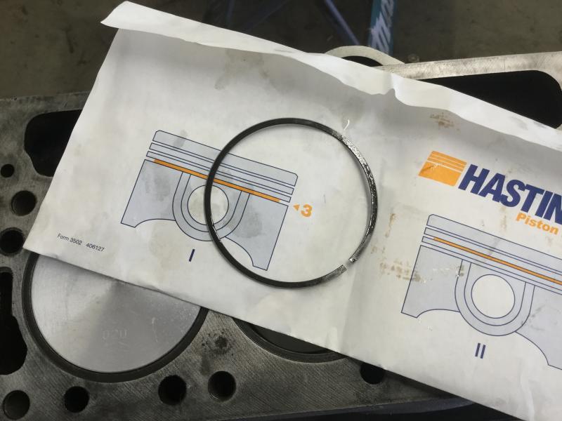

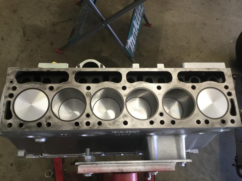

Got the last piston ready to go in and why do I have a leftover oil scraper ring? #&$@*
Why me?
Was there an extra scraper in the package?
Did I have a brain fart?
Place your bets, number five has to come out for inspection. Maybe after whiskey.

How do you know it is #5? Really a head banger on that one. Make sure it is good whiskey. :wall::wall:

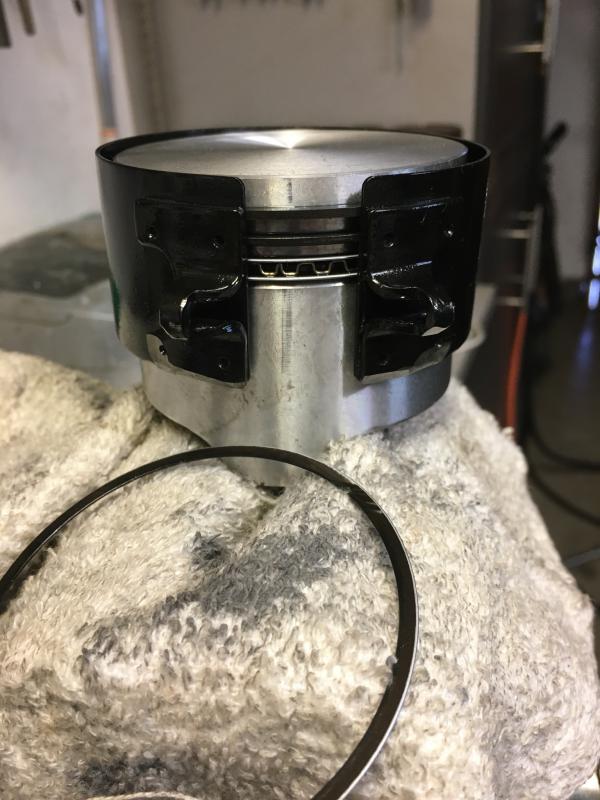

The Hastings rings come in packages for two pistons, so I got three of those packages. I was installing the final piston and noticed there were three oil scraper rings still left in the pouch... so it had to be number five piston. Or a packaging mistake, either way I will pull the piston this morning and check it. Fifteen minutes work and I'll have the answer.
To be more clear... after I installed two of the three scrapers on piston six, I had one scraper left.
Writing a song, and the chorus will be “He’s smarter than he looks.”
The Hastings package had an extra oil scraper ring in the last pouch. So I got 31 rings for the price of 30! Anyone need an .020 oversized oil scraper?
Now you don't need the whiskey please hand over the bottle. Well maybe a celebration nightcap will be allowed.
