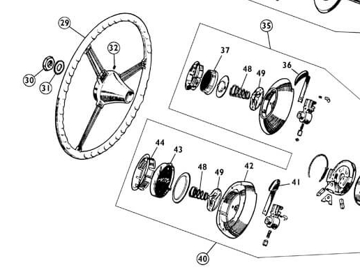

The size and shape of the horn button is a good identifier. Non-adjustable #43 is larger than adjustable #37.

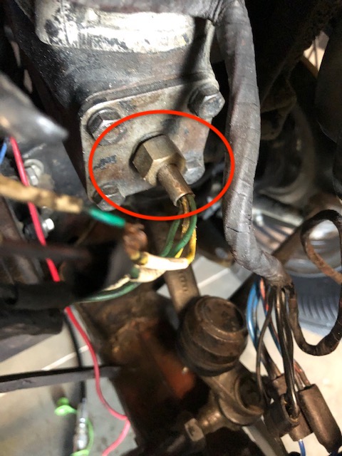

Getting ready to replace my steering wheel. Here's a picture of what the bottom of my steering box looks like (non-adjustible steering). My question is do I just unscrew the nut that has the tube with the wires going in to it (red circle) and then the entire trafficator and (long) stator tube comes out on the steering wheel side? Or are there other components that are not visible and need to be removed?
If the stator tube does not move after the nut is removed what method should I use to free it up?

G'day Chet,
Be sure not to cut the wires, they should unsnap and be different lengths to allow them through the stator tube (which you will not be needing to do). The stator tube is held in place with a brass compression fitting, sometimes referred to as an "olive". When tightened, the taper inside that circled nut compresses the olive onto the tube, thus clamping it in place. Once the nut is released, you will see the olive. If it does not slide off the tube gentle manipulation should get it loose. Bob's advice about taping the cables is good, this prevents the cables from getting soiled as they pass through the steering box.

Actually sounds easier to pull out than if I had the shorter stator tube that goes with the adjustable steering!

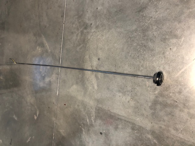

Hello all,
Having successfully removed my non-adjustable trafficator and steering wheel I figured I would post some pics of the trafficator and stator tube in case someone else needs that info.
Bob, it was exactly as you described it :smile:
