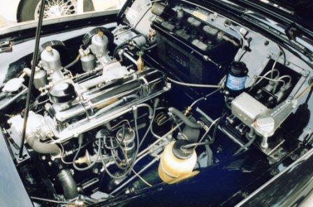

Twice in the past 21 years, the differential started to whine. It just got worse and worse. The last time I was 400 miles from home but I made it. Both times the oil had been low. Each time, I took out the rear axle (1958 TR3A) and took it to a specialty diff shop to repair it. Both times they had to change the crown as well as the pinion gears. They changed the bearings and seals too. Each time cost me about $1000.00.
In 1990, I also re-built my 1991 cc TR3A engine. Then Canada announced no more leaded gas, so I ran it like that with no additives for 43,000 miles before putting in new inserts for the 4 exhaust valves + 8 new valves and 8 new guides.
The valve seats in the bare cast iron head were receding about 0.010" per month for the last 5 months. I was checking the valve gaps every 1000 miles and the gap was closing down to almost 0.002" per month. This told me it was time (May 2000) to do the inserts. Since then, I have had no issues and hardly find any need to re-gap the clearances since then (61,000 more miles).
