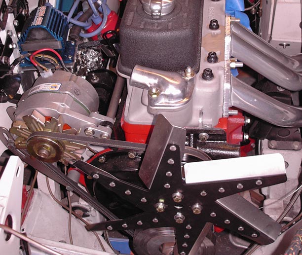

Here is a photo of my alt installed. I replaced the pulley with a larger grooved one, but it has the same alignment as the one pictured.

The need for an extension shaft still has me baffled. You might start with Anthony's suggestion on alignment by placing a straight edge across the pulleys. Maybe belt tension is too tight?
