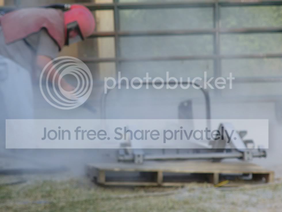

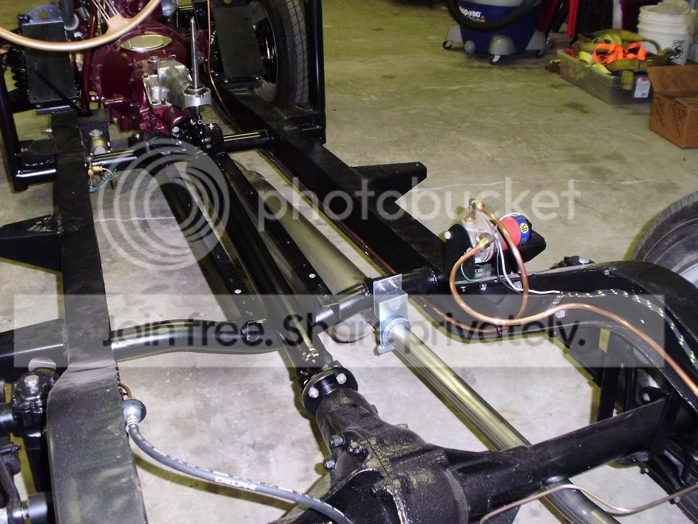

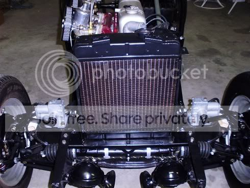

I agree also. I painted the TF chassis with Martin Senior Tuff Coat and it looks great.
First this;
Then this;
And this;
Quite a paint, of course the chassis was primed first. PJ
