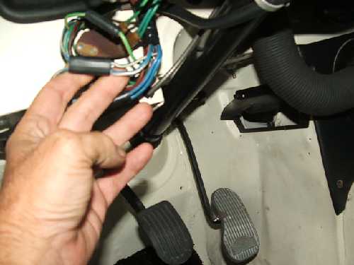

I don't know how the B pedal box is set up...
Double declutching is made a lot easier by the addition of a throttle pedal extension on the A...
If necessary, I would highly recommend the 'Patty Hopkirk' modification on your car.

As WTN suggests, a Paddy pedal extension is a really good thing.

Paddy extension in this shot is all I have on-hand:
