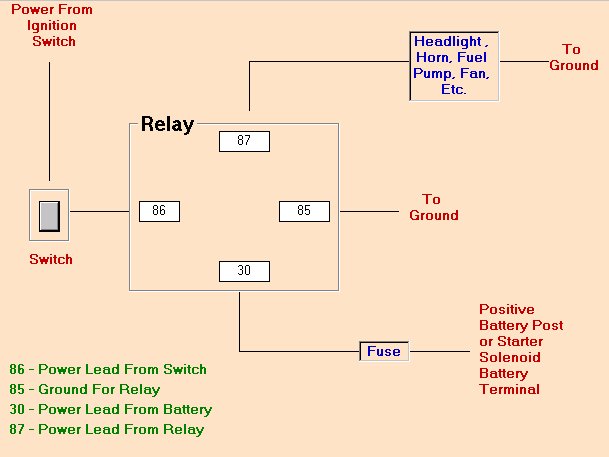

I would think it would be more effective to use the ignition circuit fed through a relay to power the coil. You could even jumper a wire from the ignition feed to the starter relay into another relay that would feed a full 12 volts to the coil. See the attached diagram. #87 would go to the coil. #86 would be the ignition feed that powers the starter solenoid.

JeffS has already suggested what I was going to mention. You can use a headlight relay powered by the red/white wire to supply the coil (+) terminal while cranking. As others have said, there should be battery voltage on the wire from the ignition switch while (and after) cranking.
Yeah Jeff, but if the starter is pulling the battery voltage down it will pull # 87 down too won't it??,if it's terminal # 30 connects to the starter battery terminal.---Keoke
As Keoke said, if you connect the relay coil between the red/white wire and ground it will see lower voltage than ideal. It will probably pull in though and it won't cost much to try. Generic Bosch-style headlamp relays are available at most parts stores for around $5. This is a much smaller investment than a late model starter solenoid with the extra (4th) terminal for ballast ignition connections.
