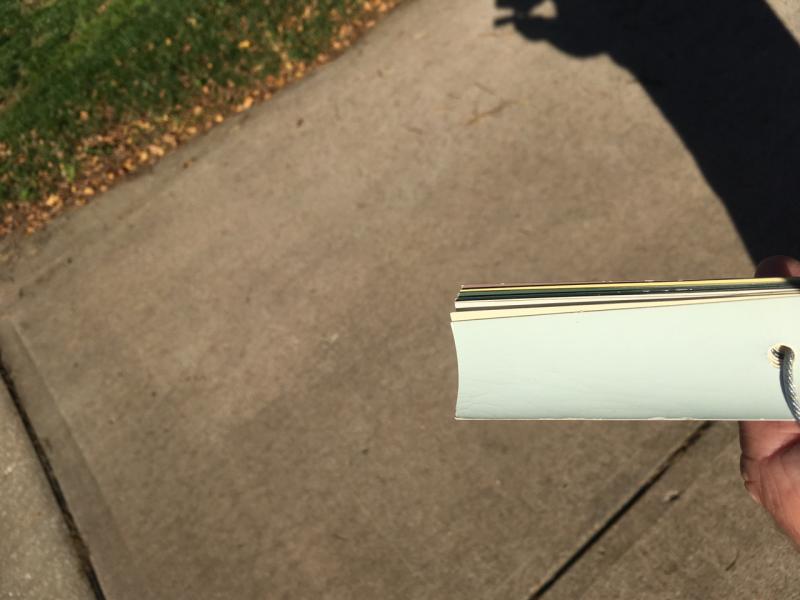

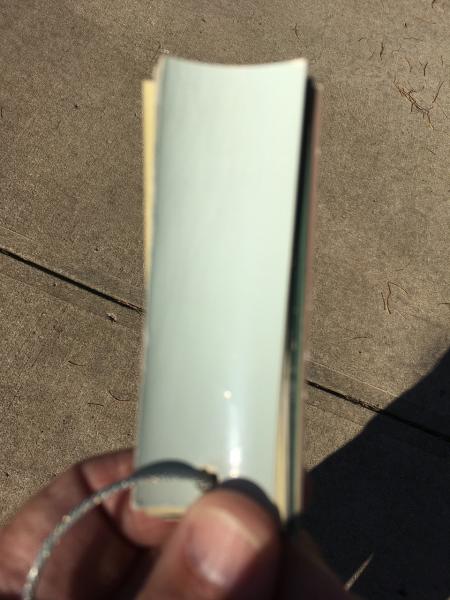

Jim,
The sun finally came out today in KC and I've attached a couple of pix of the Nimbus White chip taken with my iPhone in the afternoon sun. It's the palest of blues, really white with a touch of blue. It would be different than Ice Blue, since it doesn't have the green in it. I hope this helps.
Keith, do your chip cards have mixing information on them? I'm wondering what the original mix might have been. I ask in part because what I see in your photo -- and yes, I understand your camera, your lighting, my monitor and my own eyes all contribute to perception -- looks more like the very palest of green-white rather than blue-white. Contrast with Sebring White, if you have a chip of that color. Sebring definitely does have a very slight touch of blue to it.
As to the use of Nimbus White, I don't recall ever seeing it mentioned on the TR series, but it was used on the Triumph 10. I'm not sure, but I think its application there was primarily on the white "band" around the window areas of the Estate Wagon?

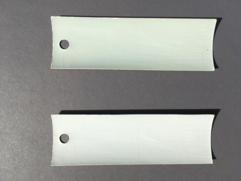

Andy and Others,
Here's a photo taken today with the sun high overhead. I used one of my photography gray cards as a backdrop. Nimbus White is "on top" and Sebring White, on the bottom. Sebring White appears whiter than I see it, it has a blue tint.

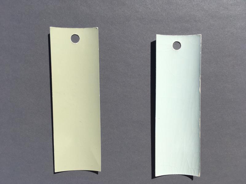

Andy and Others,
Here's Cactus (L) with Nimbus White (R). The photo shows more yellow in the Cactus and blue in the Nimbus White. Different than in person. Wasn't Cactus a GT-6 color? It's nice. I'll try to photograph all the chips here in the next few days. I would have done it today, but there was a little wind playing havoc.

Cactus usually was found mostly on Heralds, but generally NOT those built for the US market (Canadian market is another story). It was also an interior color. And yes, there were some early GT6s in that color as well.
Oh, and thanks for the comparison, Keith!
