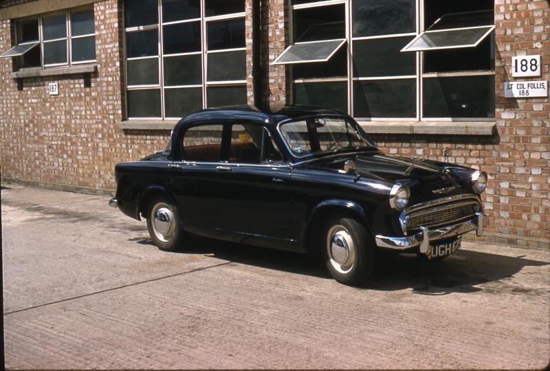

The first car I ever owned was a Minx. I was in the Air Force and stationed in England. It was driven all over England in 1960 and 61. Never had any problems with it. I sold it in January of 1962 when I bought my new 1962 Sprite that I still drive. Actually just fired it up in the garage a few minutes ago.Hillman.jpg
