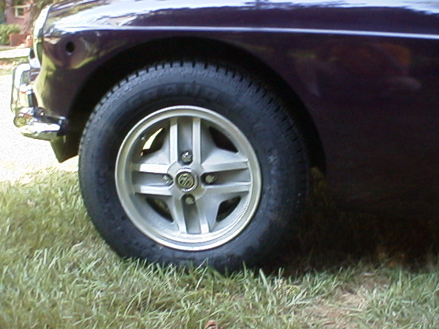

John -
Those are the same wheels I put on Janet's car - you'll find that the Rostyle caps fit perfectly!
Take care fitting them, though - the studs are just barely long enough...
Question for you Mickey, will the standard MGB lug nuts fit or do I need a different type?
Regards John
The seats in the rims for the lugnuts are tapered, so you need tapered lugnuts. I bought a chromed set from Moss - the ones with the "MG" logo. They fit well, but as I mentioned there aren't as many threads exposed on the lugs as stock, so be very careful to get the wheels seated well when you snug them up. Too bad the wheels aren't the type that take a shanked lugnut; that would take care of it.
I've driven the car without problems for a couple years; so far all is well. But I would feel better with a few more threads to work with.
Mickey

kyreb1862 said:
Hey Mickey, are those 185/70's on your car?
Regards John
They're 195/70 "generics" from Gateway Tire.
