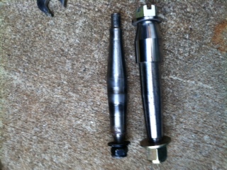

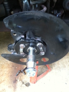

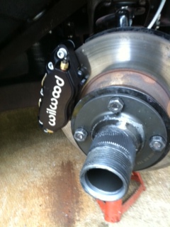

well I got the old spindles out the new up rated once installed, new bearings and calipers Pics are of old spindles and new ones,
Hondo

Hondo,
It doesn't look like you have the double-beveled nuts that are supposed to be used with TR wire wheel adapters?
Scott
