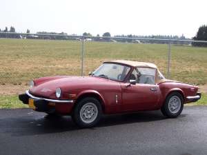

I bought my 1978 Spitfire last Sunday and love it! This is my first Triumph auto.(I had a 72 650 Tiger) The car runs very well and I have found no rust on it. It has a new top and carpet and good tires. It needs paint and some pretty minor cosmetic stuff. 67,000 miles. Now my concerns. When I let the clutch out quickly it kind of chirps. It doesn't happen if I let it out slowly. First gear synchro doesn't sync, will this cause major problems if I continue to drive it like this? And the biggie, sometimes I will be driving along and it just stops and won't start. So far it has always started after setting for a while but it scares me. It runs great until it stops there's no loss of power or anything it just stops going. I haven't been able to check spark at the plug but juice is getting to points so I don't think it's the ignition switch(although that is kind of flaky and I plan on replacing it. I suspect the coil but it's hard to confirm because it's very intermittent, the only thing that seems to be common is that it happens after it's been running for a while. Any help would be appreciated.

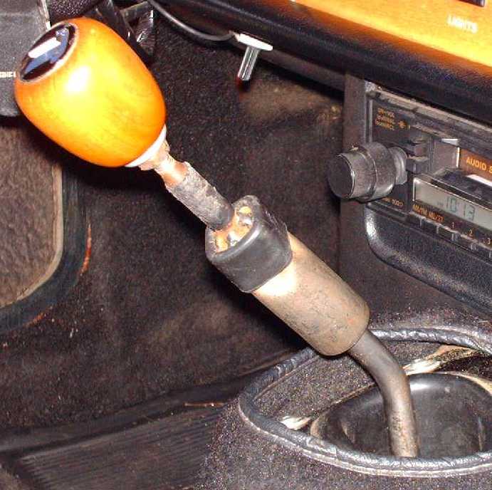

As for the gearbox, I won't ask you to tear out your interior to find a serial number./ubbthreads/images/graemlins/grin.gif But I still wonder if it might be from an earlier car. Is the shift lever slender, chromed and slightly curved, or does it look more like the one in this picture from the Spitbits online cataloge? If it looks like that picture, odds are you've a "correct" gearbox with some problem(s).
Here is what it looks like. Not chromed but not really like the catalogue piture either.

[ QUOTE ]
[/ QUOTE ]I see what you mean. Any evidence that your shift lever has been doctored or "cobbled up" somehow?
Oh...where is reverse? That might help! /ubbthreads/images/graemlins/driving.gif
Well I don't understand the the big tube thingy in the middle but it has a rubber boot at the top that looks factory made. Reverse is vertical,right,forward. It's a 4 speed no OD.

Hmmm. Interesting shift lever, too. I have no idea what that's from!
