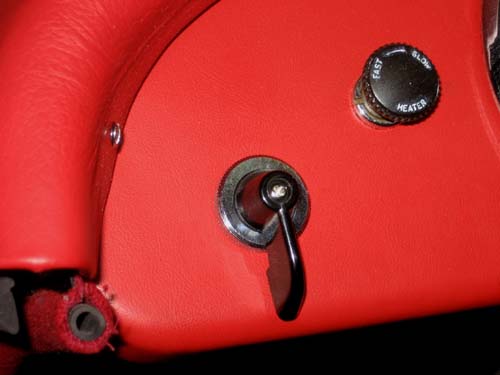

I put rack & pinion steering in the TR3 during the restoration, and I haven't seen a successful and proper way to make the original trafficator work as originally designed. Even BPNW's slip ring negates the self canceling feature of the original.
After messing with a few ideas, I gave up and just bit the bullet.
I installed an MGA pneumatic, self-canceling switch. :eeek: The horror of it all...an MG part in my TR!
It actually works quite well. It's timed, and self cancels after twenty seconds.
