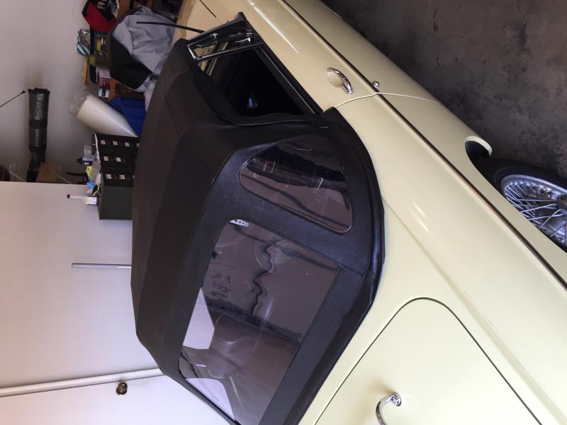

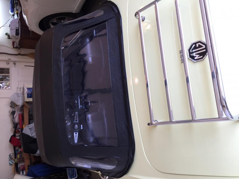

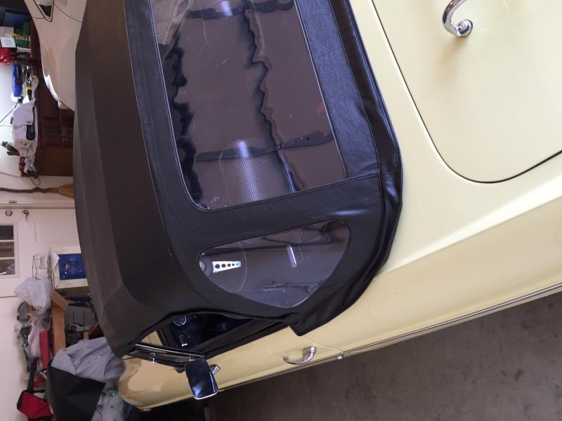

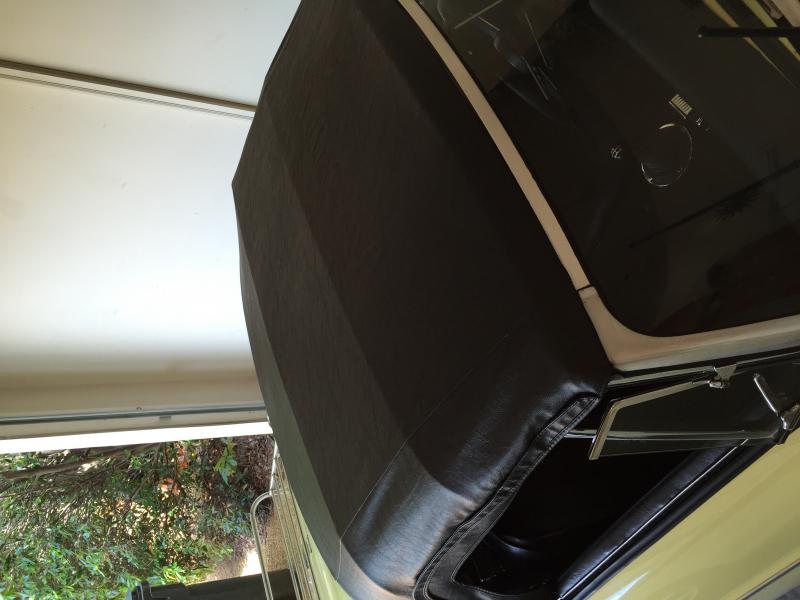

I installed my new Robbins top I got from Moss yesterday and finished up with the last 2 snaps on the front this morning. The fit looks good, but the lift a dot fasteners on the drivers side missed their mark by an inch or more. My delimma, return the top because of poor fit or keep what I've got. The install was not too bad, but I wouldn't want to do it again in this heat. I think I'll like the zip out rear window since it offers shade in our 100+* heat, but gives good air flow.

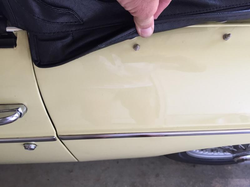

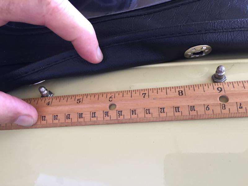

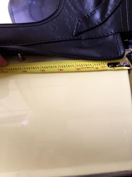

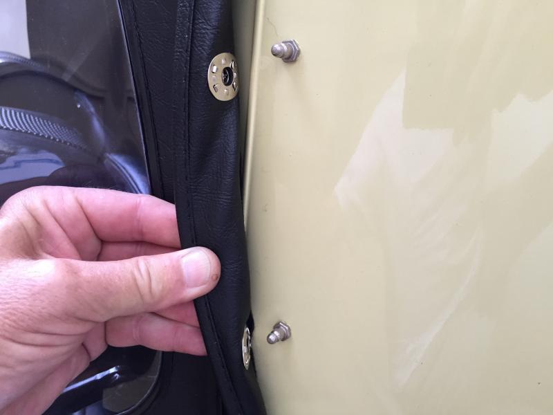

Shawn,
hope these pictures are helpful, these are the 1st and 2nd lift a dot studs from the front on the drivers side.
Thanks, Rut

I see what you are showing but I need a comparison to the other side of the car. Is it possible the studs aren't in the same place on both sides and the top is correct and the studs are wrong?
Just looking for some hard evidence and measurements that points to the top specifically so I can go back to Robbins.

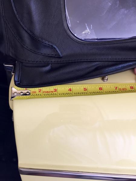

Shawn,
Measuring from the front edge of the top attached to the driver B pillar/rear wing the center of the first lift a dot is 55/8", on the passenger side it's 6" to the center of the lift a dot. Measuring from the B pillar edge on both sides the first stud is at 6".
Rut
Shawn,
Measured from the leading edge of the top its 6" to the center of the first lift a dot on the passenger side and 55/8" on the driver side. The 2nd lift a dot center is off by 1/2" to 5/8" on the driver side as well (lift a dot center is too far forward by a generous 1/2" to 5/8"). This is all after stretching as far as possible in 100* heat, so it might need an additional 1/8" or more.
Thanks, Rut

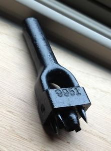

If ya do need to install the fasteners in the top, this tool is a great help (United-Carr, 9951 in this case):
attachment.php
attachment.php
I agree if they buy a good one as illustrated. I would stay away from the one from Moss and possibly other common parts sites. Reports are they break easily. Lotta money to have one fall apart. Buy a brand name tool! JMHO. PJ
Got mine decades ago, from a marine supply business. ISTR they had to order it.
The marine supplier also sold Lift-a-Dot and Tenax fasteners (for the Triumph guys).
