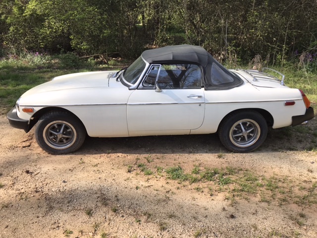

New member fro Charlotte, NC here...I just acquired a '78 MGB that is a literal barn find...as I'm evaluating things, I'm seeing that it is an old somewhat restoration...The body is in exceptional rust free condition with a very good interior and top.
The clutch is stuck to the flywheel from sitting so long, so I'm anticipating taking out the engine to replace it...also the windshield, 1/4 window and passenger door are not adjusted correctly.
My question is...how difficult is it to adjust them (windshield, door, 1/4 window)...I have no issues having to pull the engine to replace the clutch if that's necessary as I have the equipment and tools to do it.
Many thanks for any suggestions the help me get my mind right on this project...I'm looking forward to getting this little car going...I'm posting a pic for anyone interested in seeing my find.

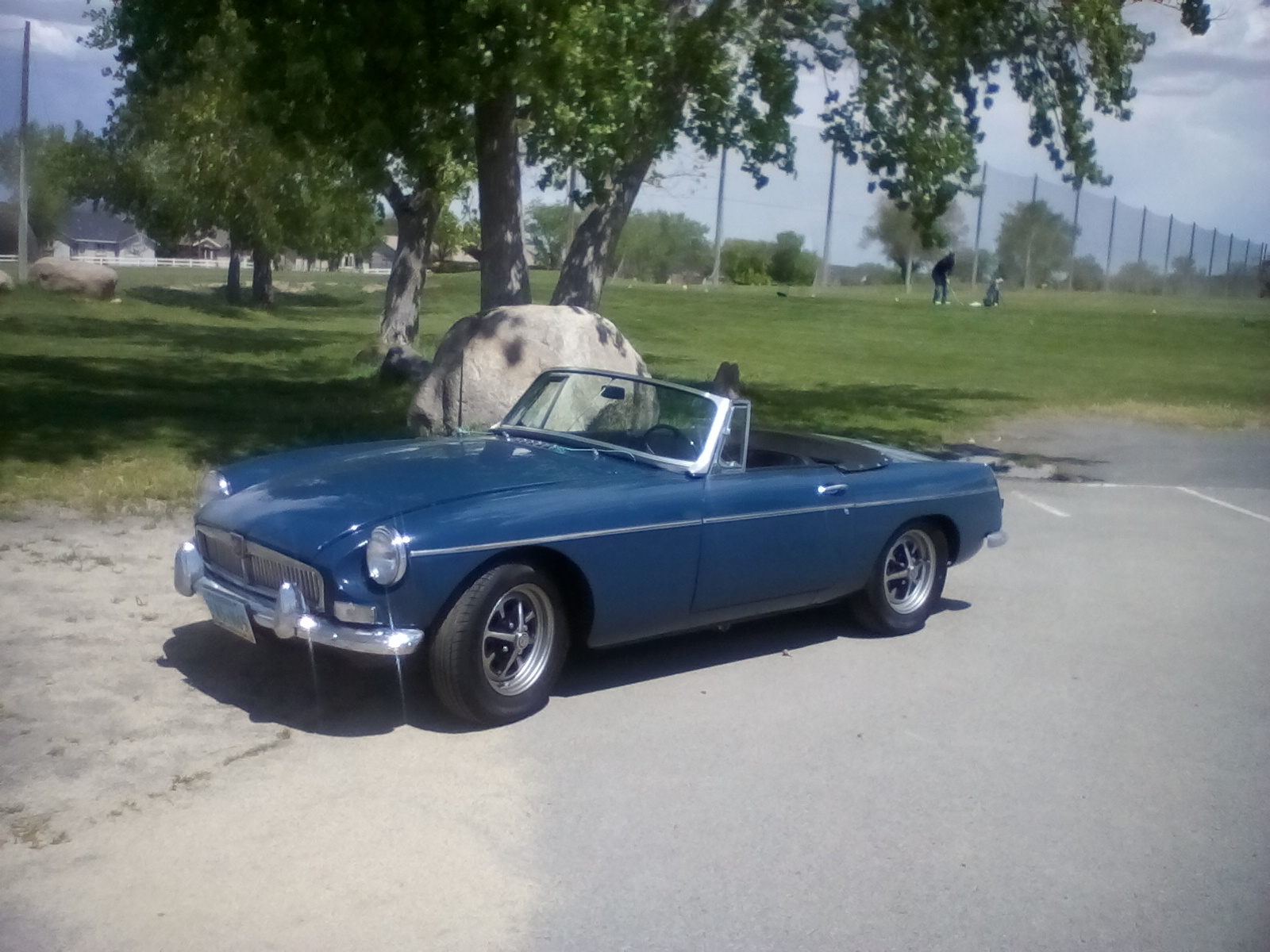

Madflyer, Very nice looking "B"
