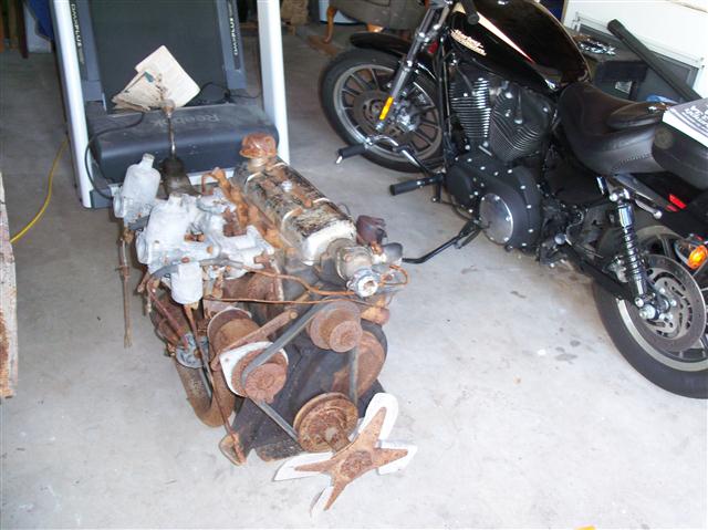

new to me engine
AnR59TR3A
This is the first of "way to many" things I will have to buy, but it is the big one. tr4 engine and trans commission # CT8247L. now i just have to clean it up and get it running.

That was fast delivery. Have you checked if you can rotate the crank yet?

Randy,
I went and picked it up as soon as they pulled it out.
I was getting ready to look for a shop manual online, but I logged on here first.
I was looking to see if I needed to do anything to loosen things up prior to turning w/ the crank. should I loosen the fan belt? any suggestions?
my sister lives in Katy so we go there frequently, I will let you know next time we come out.
ron
Aloha Ron,
I think loosening or removing the belt would be a good idea. If the water pump and generator are not seized you can spin them by hand. Otherwise the friction on the belt may stop you from turning over the crankshaft. Removing the spark plugs and a shot of oil in each cylinder should also help turning it over. The hand crank is a handy tool. Good luck.
Take out the plugs and add some Marvel Mystery Oil to each cylinder. Don't be afraid to let it sit for a day or two before trying.
Also, have you checked the oil level to make sure it's not overfull? That will be a problem when you try to turn it over.
Good luck!
EDIT: Nice Sportster you have there!!
