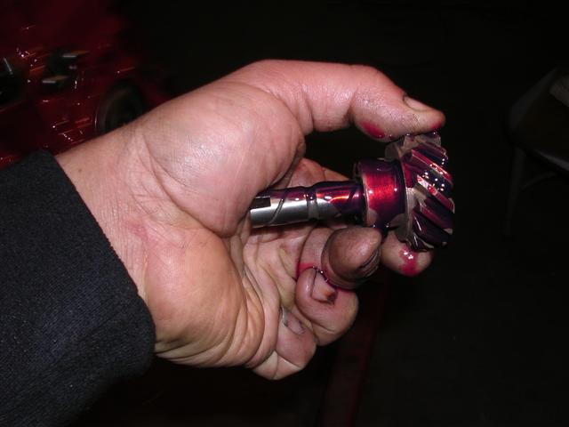

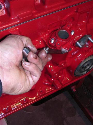

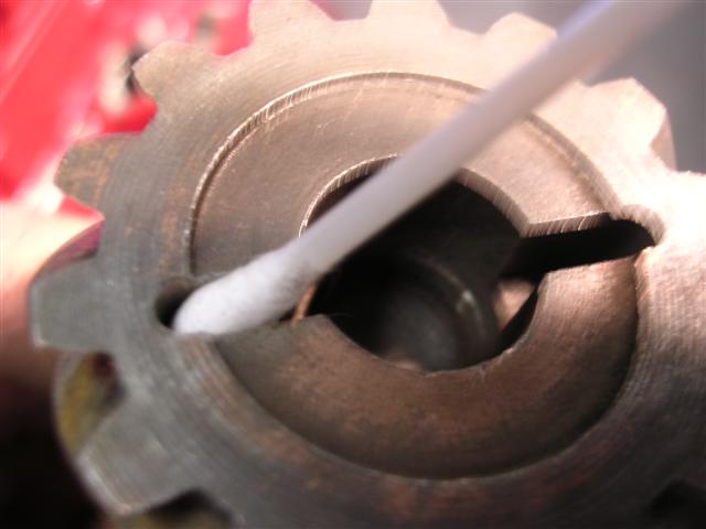

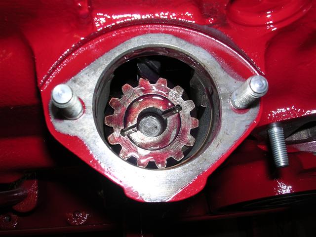

These are the pictures of what you need to remove to do what they are telling you to do. First take out the distributor, then remove the upper housing (do NOT destroy the gaskets under it, they are shims). This is shown in the first picture. Then remove the gear and you will see the slot that goes onto the oil pump drive. Make sure that you replace the gear in the same alignment as you removed it to keep your timing correct.
The gear is offset slightly, so mark the top of the gear before you remove it, to face the front or rear of the block, so you will know which way it goes back in. Lube it well before reassembly.

I had the same thing happen with my 6. I ended up dropping the pan, taking the pump out and backing the gears with vaseline. I removed the distributor and did the drill thing as others have described. I took a long bolt, cut the head off and used a dremel cutoff to make 2 offset cuts to the end of the bolt so I ended up with a tang to fit in the slot as pictured in Paul's pix. With mine anyway, I knew when I got oil pressure as the drill tried to twist out of my hand.

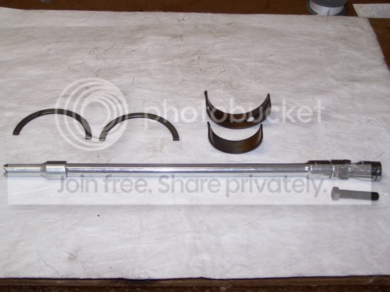

thanks so much for the advice, we ended up using the suggestions to get the oil pump turning by removing the dist. and spinning with a drill. the original triumph service manual which i have been using has no pump priming procedure in it, so we tried to get it going with the starter (plugs removed) and must have been pretty close. the problem is you never know how close you might be.
anyway, below is a pic with the old T/W's, a main, and a big end bearing and the tool arangement we came up with to get the oil pump spinning. now o/p is about 55 psi at idle w/ temps just below 1/2 way across the guage. no unusual sounds idicating throwing a bearing and no other indications of serious problems.
hopefully, with all of the assembly lube and the minimal run time (less than 15 sec's) we will have caused no grief to the 6, and we can get another 30 some years of meandering out of it.
