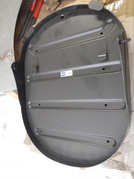

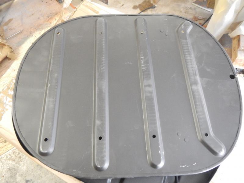

I have just received the seat pans I ordered from KAS in Australia.
The seats that came with my TR3A were in good condition apart from the normal rust around the pan. Thought of repairing the rust but the pans seemed a bit thin for welding and getting a good result.
Someone here mentioned KAS in Australia and when I checked their site I found that they sell seats or just the pans.
They were easy to deal with on line and the pans arrived today. They look great.
The exchange rate helps us here in the US. Got 2 pans and shipping for a total of $210.00.

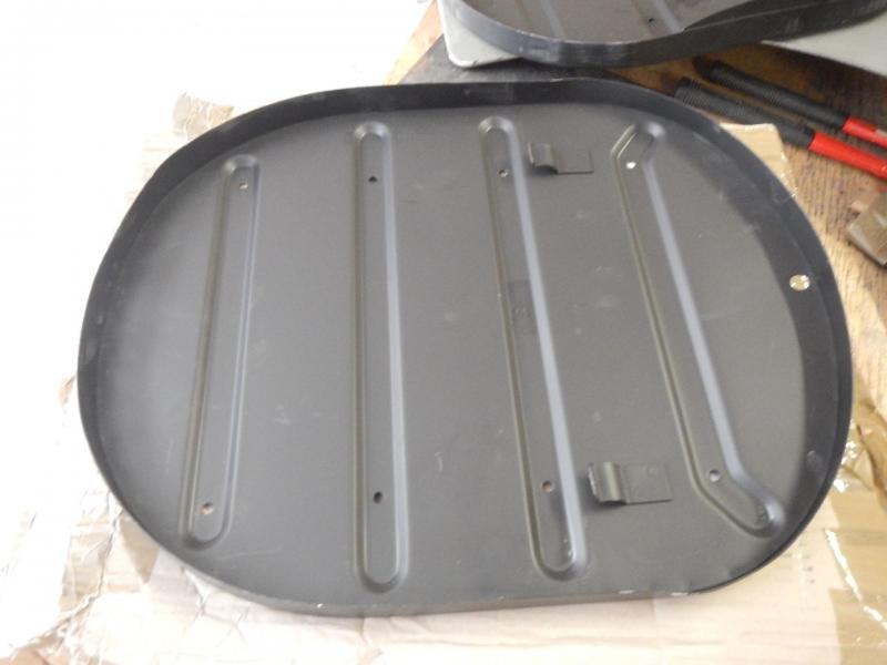

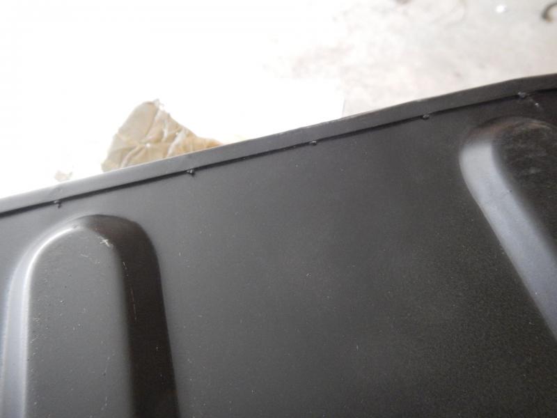

The construction looks good but is a little different to the original in that the pan is in 2 pieces. Bottom and welded rim. Almost impossible to tell from the top but obvious from the under side.

Looks like a very good option! It would seem easier to stamp it in one pop, but limiting the amount of metal stretch by making the pan in 2 parts may allow thicker metal with the finished product. Be sure to update as you trim them out.
Will do.
The cost of a press tool compared to the number of pans they are likely to make probable makes their system more cost effective, Said the pan is 20 gauge like the original with a 16 gauge perimeter on the folding seat.
They are in Delacombe Victoria

Certainly might be wrong but I always thought the seats were originally made with 18ga. Minor point though, the Aussie seats look great.
Tom
I can check the my original seat pans. Mind you rust may have reduced the thickness a bit.
It measures 0.034 to 0.040 depending where I measure. Rust and the POs paint may be affecting my measurement a bit.
David
I show .0478 for 18ga and .0359 for 20ga. so 20 would surely be in the ballpark. Remember that the original pressings would have been highly stressed and might not reflect the original gauge in many areas. However, the new two piece fabrications should do nicely from 20ga but seeing the stress fractures in most old seat frames, 18 would have been even better. Still I'd not hesitate to use them.

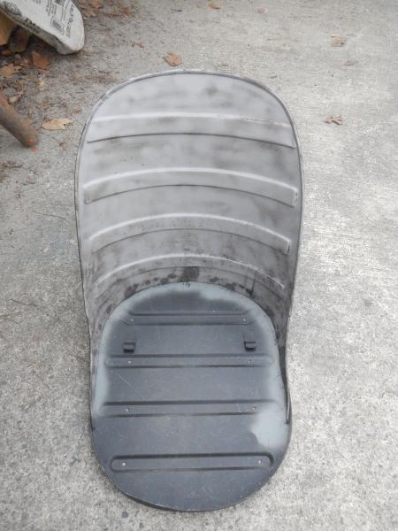

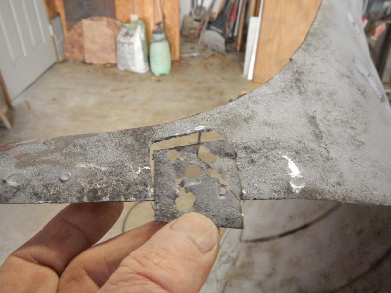

Got the drivers seat repaired. New pan attached to the old back. There was one small area that needed repair.

Glad that I decided to not try to repair the pan. The PO had just painted over the rust so I found the pan was worse than I had feared. It nearly fell apart when I worked on separating the back from the pan.

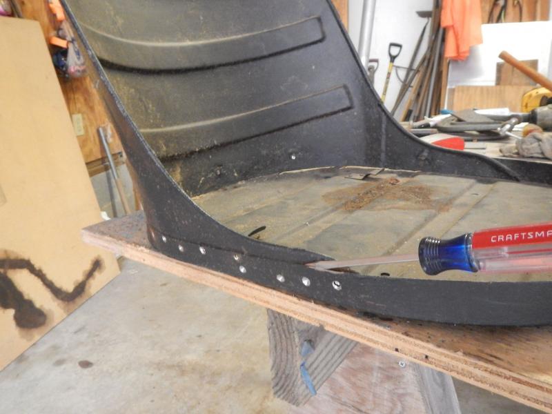

It was not too hard to do. I located all the spot welds and drilled them out but did not go all the way through the seat back. The layer of rust between the back and pan helped to let me know when I had gone far enough. There was a weld on both sides about where my screwdriver is positioned that had to be cut.
I used a Dremel cutting wheel to do that. Then I carefully eased them apart. Took an old wood chisel and tapped it down by each spot weld and worked my way round the seat,
Then sand blasted the back and put a small patch in one side. Sprayed the mating surfaces with weld through primer even though the car will not get left out in the elements like they were when they were in their prime. Punched weld through holes in the new pan in approximately the same positions as the original.
Using a combination of wedges, clamps and vice grips I got the back and pan pulled together
