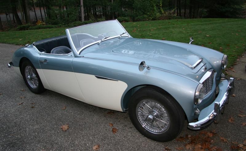

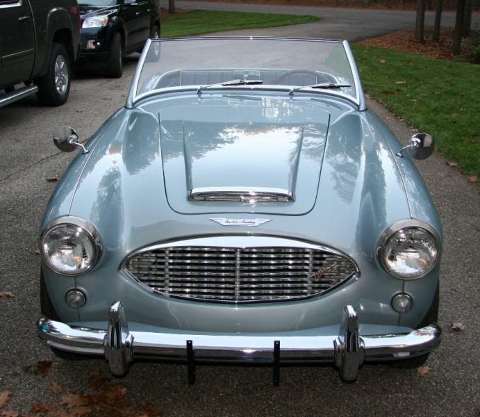

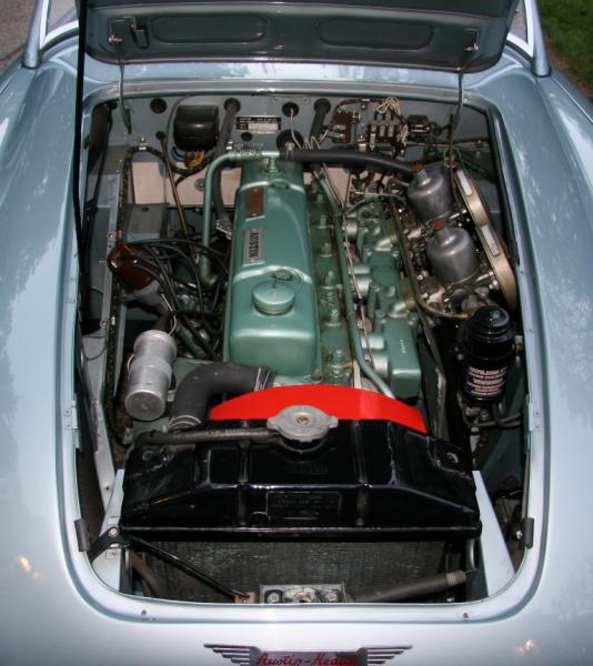

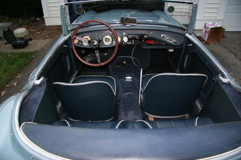

While I've been a member here a long time, and done a LOT of reading, I have not owned a British car until recently.
20 years ago I helped a friend restore his 1959 Austin-Healey BN4 100-6, and about 2 weeks ago I purchased it from him. While (sort of) driveable it needs some finishing touches, and someone who is more mechanically inclined. That would be me, so I now have a winter project.
I've been making a list of what needs to be done, and will have a list of items to repair or order. As time goes on I'm sure I will have questions.
Working on American cars, specifically Corvettes, is very familiar to me. The Austin-Healey is all new in many respects, but at least many of the principles are the same.
If you don't mind, I'll start out with one question - are all of the fasteners on the car Whitworth, and if so what tools should I obtain? I have a large selection of SAE sizes as well as metric, but even with the little work I have done so far I can tell that some of the bolt heads are "not quite" the same as the sockets I own.
Any suggestions would be appreciated.

I don't think you will come across many whitworth fasteners on the '59. I don't have any on the '57 I restored. Overall it looks like a nice job so far. Welcome to the forum!

…forgot to add. That's a very nice looking car that doesn't seem to require anything except maybe a tune up. Nice to see the detail touch of the crankcase vent rubber connections sprayed green as they came out of the factory.

Welcome to the Healey world ! Looks like a very nice BN4, love the color combo. I've owned Brit cars since 1968 and never had a set of Whitworth tools. Even restored a 1949 MG TC over a 20 year period and although probably could have used a set, did fine with metric and SAE. Haven't needed a set on the Healey's I've owned either.

Beautiful color, one of my favorite combos. From the pics, looks like your steering wheel needs to be adjusted. With the wheels straight ahead, the steering wheel should have one spoke located straight up at noon. This allows the gauges to be clearly seen without being blocked by the spokes. Looks like it will be a lot of fun, enjoy.
