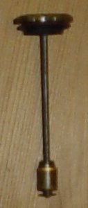

Does anyone have a closeup of how the little damper piston is supposed to be assembled on the shaft? Mine is very hard to insert after I put oil in there.
Yes, will be tight as you push down and oil leaks past the plunger, but should not be a big deal. If so the bypass is pluged, dirt.
Nope! I scrubbed it and cleaned it out a bit. It has all the bits and just needs a good rebuild. The damper SHOULD be hard to put in with oil: that's its job... If not, it's shot. the second outlet is because it's the "first" in a pair and the "twin" is supplied from the other tube... Rob has its "twin."

The damper is assembled correctly, BTW.

as for the plunger:
I've not deployed mine yet... waiting to see if I hafta go visit a butt sniffer this year. Plus, mine needs rebuild. The jet tube at the bottom was a little on the brittle side... /ubbthreads/images/graemlins/smirk.gif
