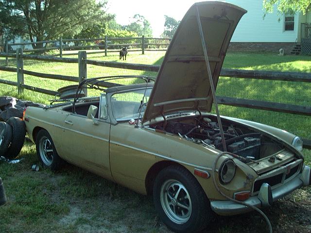

This one has been parked in a carport since 83. I got it running yesterday. It will have to wait till i get the 69 completed first.

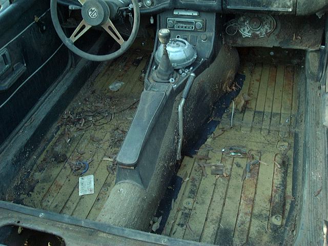

Looks like the floorboards are in decent shape. How about the rest of the body?
There are a few pin holes in the original dog legs. Thats it for rust holes. Looks like it was parked because of a clutch issue. I will probably start tinkering on this one in a few weeks. I am helping a buddy get his MGB ready to paint and that will tie up my large shop...ER..one work bay shop...He is doing the work and i am the coach. Even as the coach i got pretty dirty today. Now how did that happen? Bob

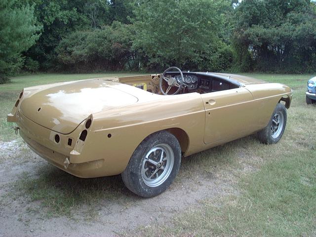

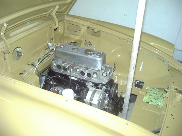

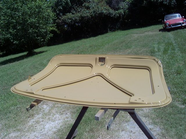

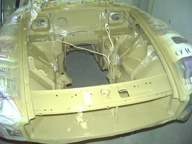

Update..The body is in final primer and i have the wheel wells painted body color and the car is now jambed out. Tomorrow i will install the hood,trunk and doors and begin the wetsanding process. The engine will be the 1800 cross flow unit i purchased about a month ago. It has 5-6000 miles on it. A E-bay purchase of a set of Libre 4 spokes will keep the tires attached to the car. I have a set of rebuilt kingpins and red bushings for the front suspension. And yes its going to be the original Harvest gold. The trans will be the O/D from the 79 white parts car. More pics later! Bob

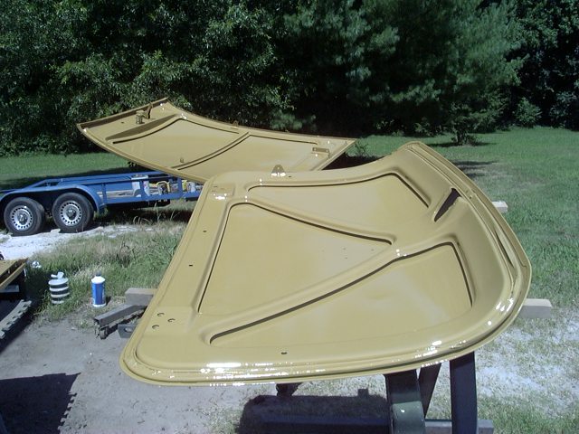

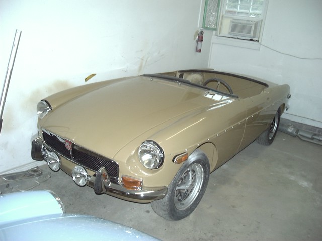

Here is a updated pic. or two. Just so you know i am not being a complete slacker. I have alot of extra harvest gold base if anyone needs any touch up paint! The paint store mixed 2 extra quarts by mistake and i ordered one extra. Bob

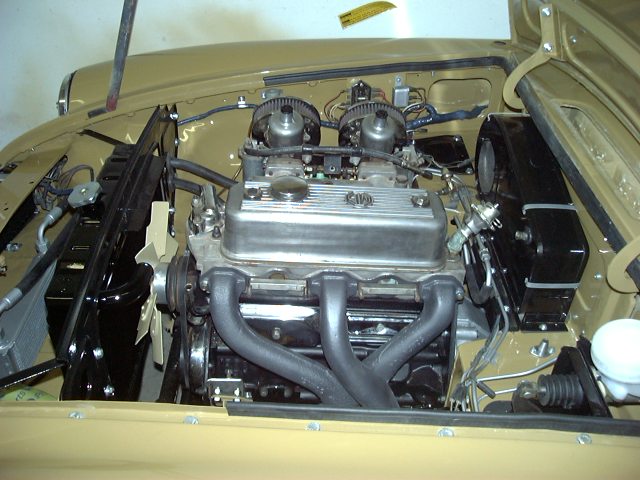

I have a question (based on almost 40 years of wrenching and now Brit car ownership):
There are what I hope are temporary spacer blocks between the flanges of the headers.
How does one reach the spark plugs with those in place?
Just wondering is all.......aloud, no less.......
Dave
Dave, The spark plugs are on the other side. I have not installed the large flat washers to hold the exhaust on yet. The flange on the exhaust manifold is about 1/8" thicker than the spacer blocks and i will be welding a half moon shim to the washers so the studs stay straight. Bob
