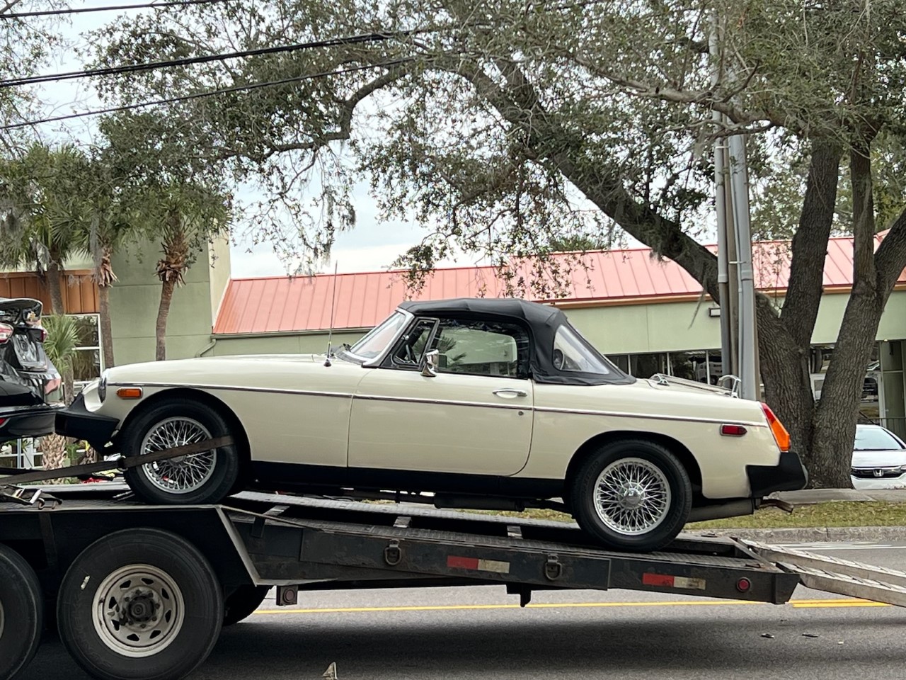

I just purchased this 78 MGB. I owned several MGBs in the 70's and a 59 MGA. Fast forward to today..I got the car, drove it once and had a major brake problem. Also had the clutch cylinder and a leaking hose repaired. The dash lights are not working and I was told the electrical harness needs replacing. Wow! I didn't expect this kind of expense right away. I thought about just cutting my losses and selling it, but I may hang in there and try replacing the harness myself. I've been watching "how to" videos on harness and dashboard replacement. You may be laughing at this point at trying to make this a DIY project, but any tips would be greatly appreciated. Below is my 1975 B (with a much younger me) and the 1978 on the trailer in Orlando being shipped to me in South Carolina.
