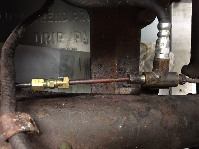

The Healey had a brake failure (fortunately gradual, not catastrophic). You can see in the photo what caused the failure. At some point in the dim past somebody patched the rear brake line with an ordinary compression union. The photo shows the three way fitting coming from the front of the car and the top of the pic is the compression fitting going to the line that goes over to the left rear wheel.
Although it would be quick and easy just to make a new patch with a new compression union, I guess my only real choice is the buy the entire brake line set from Moss Motors for $116 and replace the read pipe, including all of the wonderful bends going over the differential and then down to the wheel.
Any other thoughts? Just buy a few feet of tubing and make the replacement line?

Interesting photo. I hope the break line just goes behind the rubber hose and is not stabbed into it.
The break line kit is probable the best approach as it will come with the correct flares on the pipes. Some old British cars hade a different flare than is used now. Also the nuts would be the correct thread.

Thanks for the quick reply. When I looked more closely at the system and at the possibly differing types of flares I decided to just go ahead and buy the Moss Motors kit.
