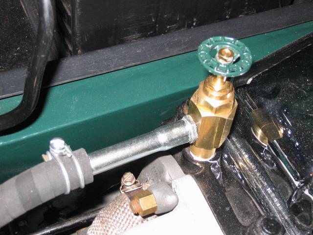

The little valve at the rear of the cyl head opens the heater,but sometimes it is stuck or clogged. Good luck

I suggest you buy a couple of manuals. These are available from any of the major parts suppliers. Notally you turn on the heater by opening the valve for the heater to the fear of the engine. See attachment. If it will be inside, you only need to remove the battery, put on your workbench or on a block of wood on the concrete floor and charge it for 24 hours every month. Wash the car and cover it with a car cover or old blankets. This is mainly to prevent scatches from others who walk by the car in the dark with a bag of groceries, etc. I never run mine during 5 months of winter storage. Most engine wear occurs when you have no oil during start-up. Starting it once in the spring is less damaging than starting it every moth. Also during the winter, I change the oil and in the spring, I remove the sparkplugs and turn the engine 50 times with my hand-crank, then about 50 cranks with the starter. This gets the oil flowing and once I put the plugs back in, it starts right away with good oil pressure. This is all I have done in the last 16 years with mine since I did a full restoration from 1987 to 1990. During that time I have driven it 94,000 miles.

https://www.britishcarforum.com/ubbthreads/photopost/showphoto.php/photo/1919/ppuser/4127
