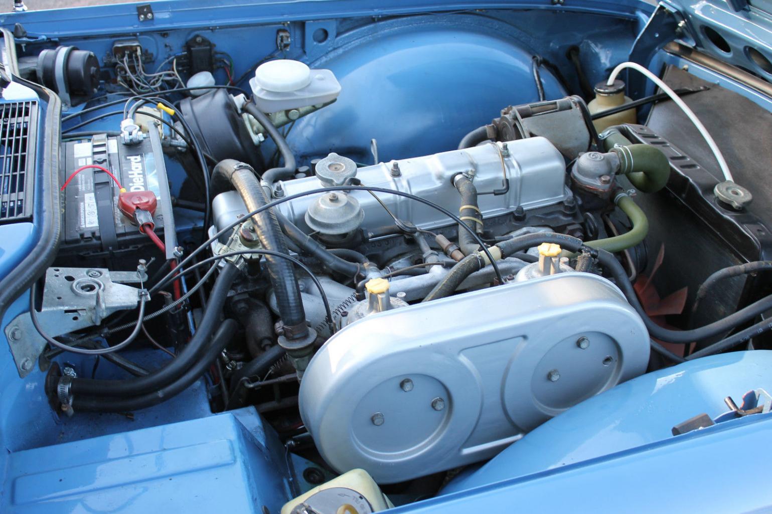

I have talked to Jessie Palmer from the Carolina Triumph Club. He has been a big help. Got the Pertronix installed. Windshield Washer was a disconnected wire under the dash and disconnected jets. Leak turned out to be a bad clutch slave which is now fixed. And I replaced the LH horn and now everything works! Car doesn't want to restart after it has warmed up....engine just turns. Cools down and starts right up. So I got a heat shield from ARE and just finished installing it, along with a new ignition wire (battery to solenoid). Set the timing. So it is looking good. Some really good advice on some of these BBS'. Triumph Enthusiast has been a real help.
