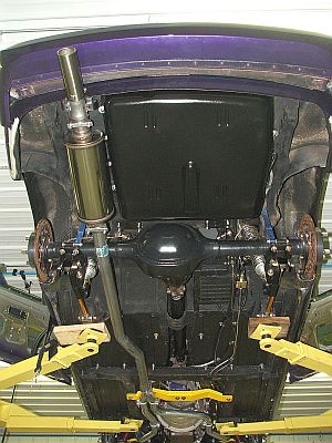

I cleaned my new tank up, then used a truck bed liner on the top and a good enamel on the sides and bottom.
A really nice job Rick ! You do good work...wish you were working on ours :smile:
