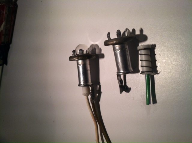

well got my brown yellow wire from British wire and I found on old bulb holder I can use for the ignition lamp, I got the BY wire soldered to the out side and have a short white wire I will have to use a crimp joint to install
