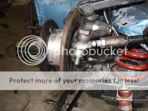

One solution is to set the car up with racing-type rod ends. This would require reaming out the tapered hole to an exact, straight diameter and fitting a rod end with the appropriate female thread and hole size.
Not everyone would want to do this, but if you do, use good quality rod ends (not the cheapies!).
You may also want to use a safety washer at the lower end.
Here's a photo of what I'm talking about(I'd bet some of you have already seen this elsewhere). This car has the bigger (Spitfire) rotors and also uses a spacer for the arm.
It might also be possible to keep things stock and simply use a spacer like this to more the arm away from the hub carrier. I'm not sure how much this would affect steering geometry but a thin spacer might be OK.
Just some food for thought......
