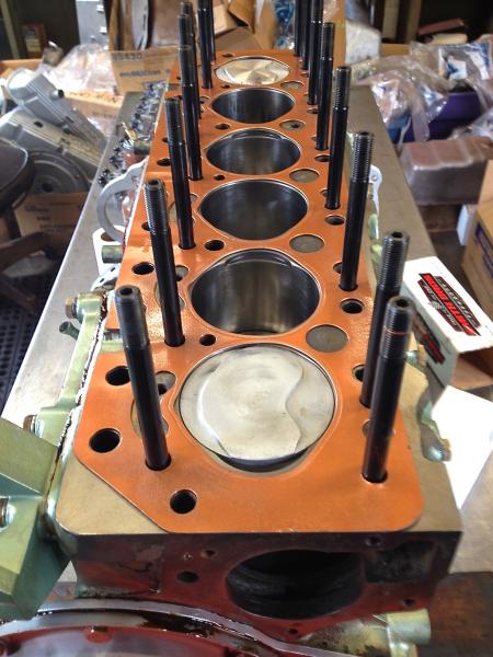

Randy - Your photos aren't showing.
John - I have a DW 6-cyl aluminum head that I bought and installed 13 - 14 years ago. It's been fine. The head didn't require any tweaking, but the DW8 cam caused my machine shop fits because they had to cut intake valve pockets into the block.
Still? I can see them, anybody else?
John, ordering the dw8 cam as well, will see how my machine shop does with valve pockets.
A good, experienced machine shop should have no problem with milling valve pockets. You just need to determine the proper depth for you cam.
