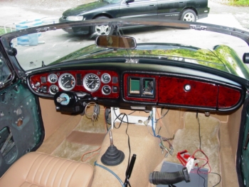

Just finished reinstalling my 78s dash back into the car after replacing the dash face and adding woodgrain applica. The job is not to difficult, just make sure that you have the cover in the exact perfect position before using the contact cement. I assured this by cutting out around two of the small gauges on the diagional and sliding the gauges in their position as the cover was glued on. You do not have much room for error as it must be almost spot on to install the glove box and gauges. Above is a attachment (picture) of the finished product newly installed, well worth the trouble.
